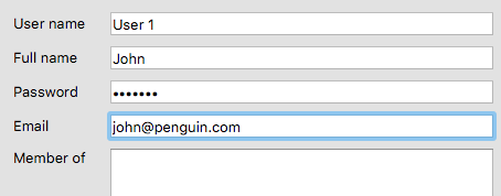

When defining a user in Switch you can also set the users e-mail address.
That information will show up as the variable Job -> UserEmail

Penguin
Posts: 34
Joined: Tue Jul 31, 2018 5:57 pm
Re: Submit point user to email
Post by Penguin »
I've done all those ways but for some reason it still doesn't pick up the email. I was hoping maybe I was missing something in the settings. Thanks for all your help. I'll look back through and see if I missed something wouldn't surprise me if I did.
