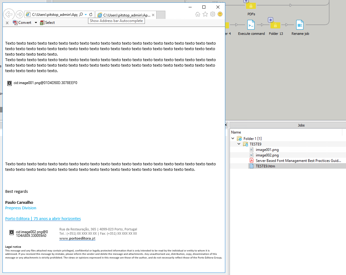

The problem is when I print the email (.htm files) it prints without the images that are in the body.
The files are referred in the body email with cid:image001.png@01D45D....
i'm using wkhtmltopdf.exe in command line to print the .htm to PDF.
Does anyone have an idea how to solve this and print the email with the images?

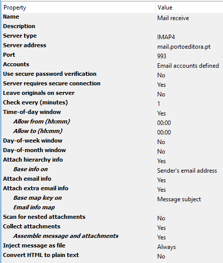

Here are the properties of the Mail receive.

You can save the signature images (image00n.png) in a separate folder, with user-managed path.
Then edit the html with a script, and replace the images paths to the folder defined above + image name.
Then convert the html body to pdf.
