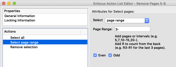

I'm trying to use Pitstop Server but the file just passes through the hot folder without being processed how do I make it process? I'm very green for the record.
Malcolm Mackenzie
Posts: 129
Location: London, UK
Re: Delete pages from PDF
Post by Malcolm Mackenzie »
The report needs to go to another PitStop element and run a saved action as below
