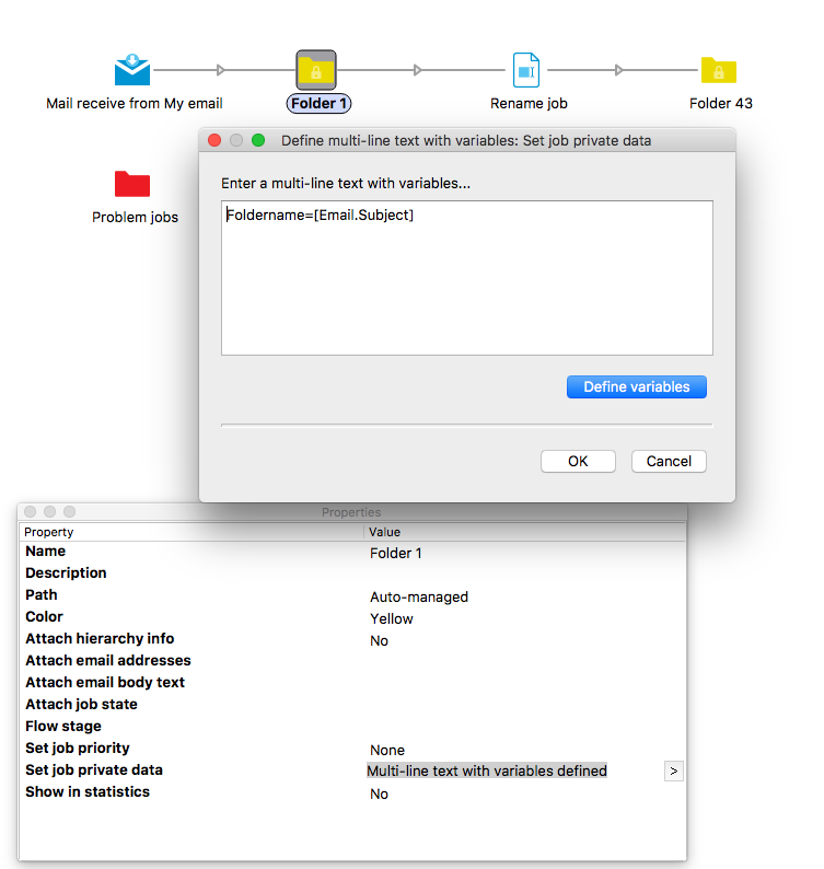

Try setting the data you need to private data items as soon as the job comes in. Run the script on just the private data item that contains the special characters. The rest should not be touched.
With the most recent version of Switch. there is an option in the folder properties to set private data items, so you don't need a special script for setting them. The syntax is
key=value (one key per line). The value can be a job variable such as the email address, subject, etc...
In your script doing the replacement, you will now reference the private data key and change it.
Also, your Rename job element should reference a script expression, not a regex. You do the work in the script expression and return the result as the new name.

Thank you for the response.
This is fairly new to me and I am not quite getting it.
Could you look at my screenshots and tell me exactly where I am going wrong?

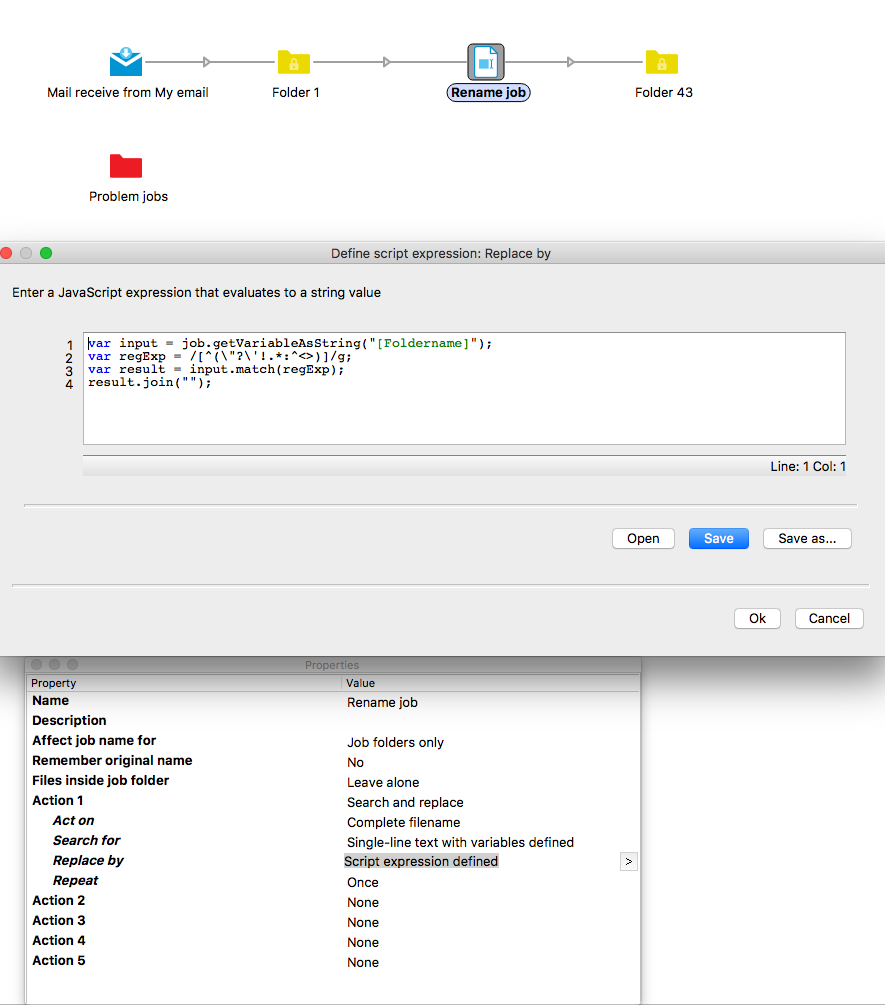

script change name.png (121.94 KiB) Viewed 21481 times

From your screenshots, it looks like you are setting the private data correctly, but not calling the right value in your script expression. Do you have the Scripting module? It makes working on script expressions and full scripts much easier, because it comes with the SwitchScripter writing tool. You can create a "test environment" to try out your script and see if it gives you the correct result.
Anyway, I digress. The value you need to call is job.getPrivateData(Foldername). Also, you will need to pass back the value in your variable "result" at the end of the script. ALso, I am not too sure about your regExp, I think some more of those characters need to be escaped.
var input = job.getPrivateData(Foldername);
var regExp = /[^(\"?\'!.*:<>)]/g;
var result = input.match(regExp);
result.join("");
result

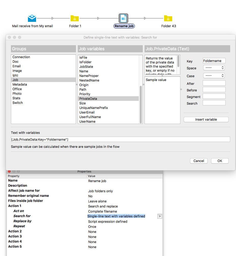

one of my screen shots did not post right-
This was supposed to be in there also.
Am i selecting the private data right?
select private data.png (162.39 KiB) Viewed 21479 times

It's really much easier to see if you are getting correct results by having a "live" test job in the flow that has actual data attached to it. Let's go back to what you are trying to accomplish. From your original post, you want to create a folder that is named after some incoming email data, and store any attached files in that so-named folder.
The set of data you selected were: Email.Subject, Email.Subject, Email.Date. So, now you have to get your folder named. You need to pass back from the Rename Job element the folder name. How to best go about it? Well, what I would try and do with limited working knowledge of how scripting works is use the Rename Job element to do the building of the whole name. A script expression can be used to work on the subject data, then use Add Suffix in a following couple of actions to add the rest of your data.
Within the script expression,the Email.Subject cannot be called directly (at least, I couldn't find a reference in the scripting guide), so you will need to set that information to private data in order to call it in the script expression. Once your script expression is working correctly and passing back the data you expect, then just add the last two pieces by calling the data from the Email information held in the job.
You should test your regex statement in an online regex tool before entering the pattern in the script expression. That will make sure it's doing what you expect it to do. You should also check what the Email.Date variable is going to contain; if the data is formatted with slashes "03/25/19", that's going to be a no-no for the folder name as well.
