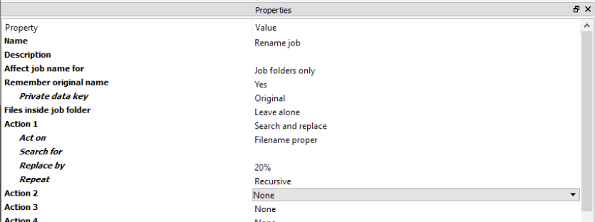

If you do rename and set it to search for Inline Value and it really is a space on the space bar.
Sort of like below (should be %20) it should work.

Malcolm Mackenzie wrote: Mon Mar 25, 2019 6:39 pm Hi
Hi Malcom,
Not sure that you can use Rename to modify metadata values?

Hi Lars
My stupidity for not reading the issue correctly.
