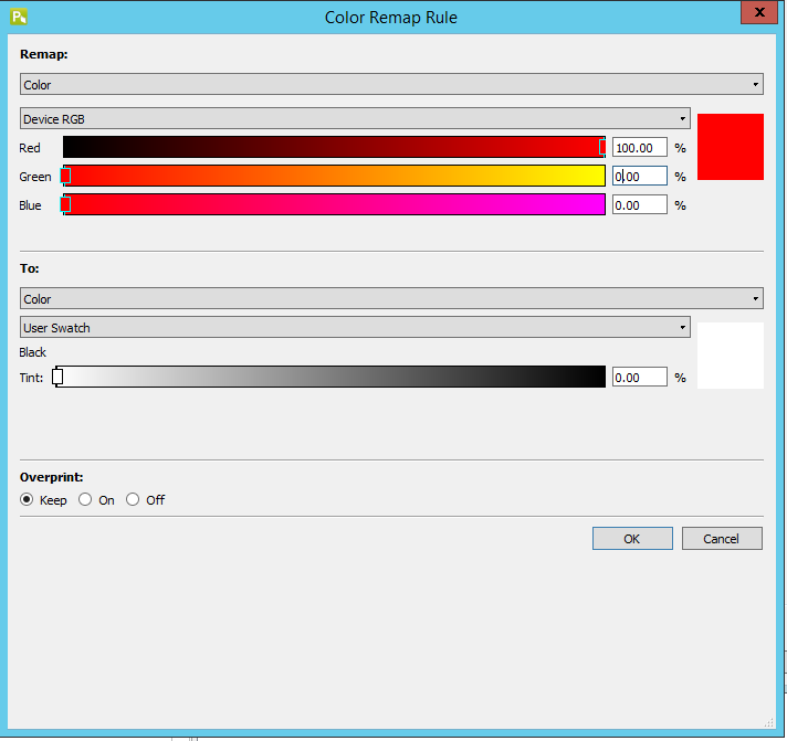

Re: RGB Colour to Spot Colour
Hi Malcolm,
Thanks for your reply. When I do these steps I don't seem to get a choice in which Pantone colour I would like, any suggestions?
Many Thanks
Cwhiteley
Many Thanks
Cwhiteley
- Remap Options.PNG (16.47 KiB) Viewed 40527 times
Not sure why, maybe a PitStop Version issue.
What version are you on please?
abailescollins
- Advanced member
- Posts: 458
That looks like it's from PitStop Server.
You don't have access to the Color Picker and Grab options in PitStop Server as the color databases aren't present.
The way to do this would be in PitStop Pro and then to import the Action List into Server either as an Action List or an Action List embedded in a Preflight Profile.
Ok, thanks guys I'll try to import it as an action list and let you know how it goes.
Many Thanks
Cwhiteley
Many Thanks
Cwhiteley
Importing as an action list worked perfectly, cheers!
