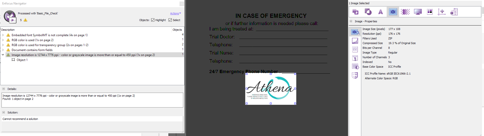

I am experiencing (not the first time) an odd Pitstop behaviour, where Inspector is showing different values than those that come from a preflight report.
In particular - it is about image resolution / size.

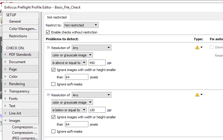

Below is an extract from the custom Preflight Profile that is run on the file
And here are the results compared to the Inspector Info on the same object.
Why ??

Can you please turn on the resolution preflight option to ignore soft masks and see if that makes a difference.

It did indeed. It is not reported with incorrect resolution anymore. Interesting...
