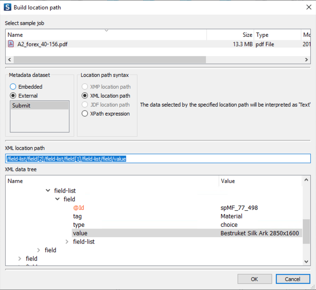

All information entered in the Submit point is accessible as Metadata in Switch.
If you put a hold in the flow and then submit a file and waits until it reaches the hold, you can then stop the flow and use Define condition with variables and the go to Metadata - Text - Build location path and select Submit to find the metadata you need.
To make it easier for yourself to know what metadata you use for your selection you should use a path like this: [Metadata.Text:Path="//field[tag='Material']/value",Dataset="Submit",Model="XML"] rather than the standard /field-list/field[2]/field-list/field[1]/field-list/field/value. The tag is the name of the metadata field you want, which in my example is Material.
Skärmavbild 2019-05-08 kl. 07.29.32.png (210.77 KiB) Viewed 16449 times
This value can then be used for whatever purpose you need. For instance, say you have three different action lists you use depending on what was selected in the Submit point. You could then do a branch using that value and set a Private Data key that you use to select your action list.

I'm talking about the hold you can put on a connection in order to set up your condition with variable, not a Hold job.
If you put a hold on a connection, wait until the file reach that point in the flow and then stop the flow you have a sample job in the flow that you can use for setting up conditions.
