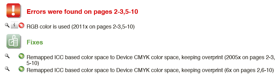

I don't think it has to be that complicated. Just make an action list like this.
Select all
Check RGB color is not used for any object
Remap Color (make sure to remap both RGB Space, CalRGB Space and ICC tagged space to CMYK)
This will give you a report that logs the use of RGB as an error and the remapping as a fix
