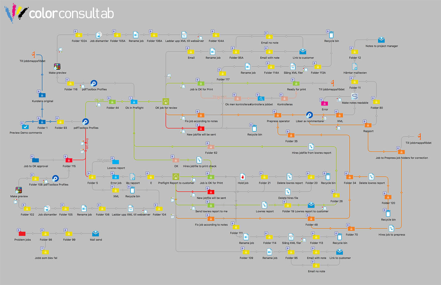

If the customer see the PDF report in PDf Review instead of the original PDF then you have either to change your flow so that it is the original that the customer see.
Or let them see the report it there is warnings or errors and in PDF review they make decisions on what and how the PDF should be treated. Then if they decide that the PDF should be printed anyway they say OK to the job and Switch will pick up the original PDF from a repository. If they decide anything else, like tell you to fix problems or they send you a new file the original in the repository gets deleted.
Here is a flow that does just that. Customer sees the PDF Report with all errors and warnings as annotations. They also get a report in the email with the link, that email also has a preview of the PDF's first page.
PDF Review flow.jpg (167.71 KiB) Viewed 7021 times
Email me if you have any questions on this flow.
