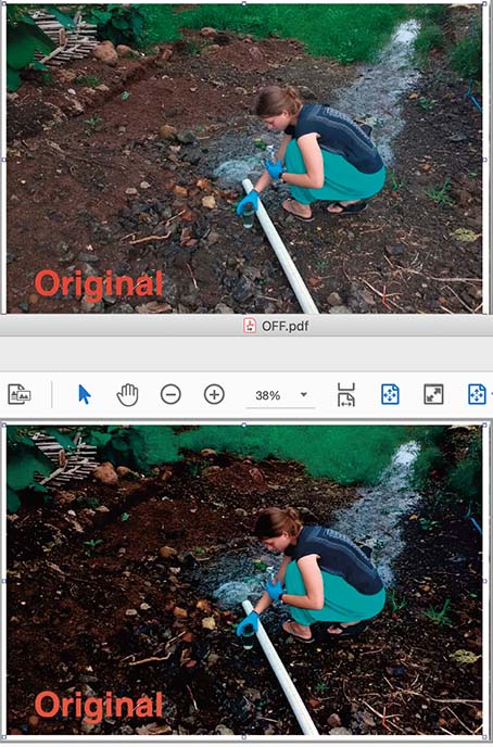

You can see this directly on screen.
The Picture on the upper left side is the original. The one on the upper right was converted on one computer with the exact same settings ... the lower left was converted on another mac ...
We've got four macs here ... two produce the right and the other two the wrong result.
... an we've got no clue ...

You only need to worry about the PitStop Color Management preferences.
I took your original posted image and did a test using the profile configuration you had (see attached).
The darker one has color management turned off in the PitStop preferences.

Thank you so much - that was the solution.
Great support .... many many thanx :-)
