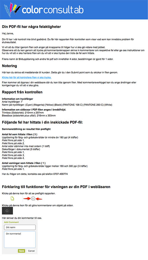

Here is an email with part of a preflight report made as an custom template. In this case it is the eamil that is sent to customers with a link to PDF Review. It will list the warnings and error found in the preflight of the job.
- pdf_review_email.jpg (83.65 KiB) Viewed 28413 times
