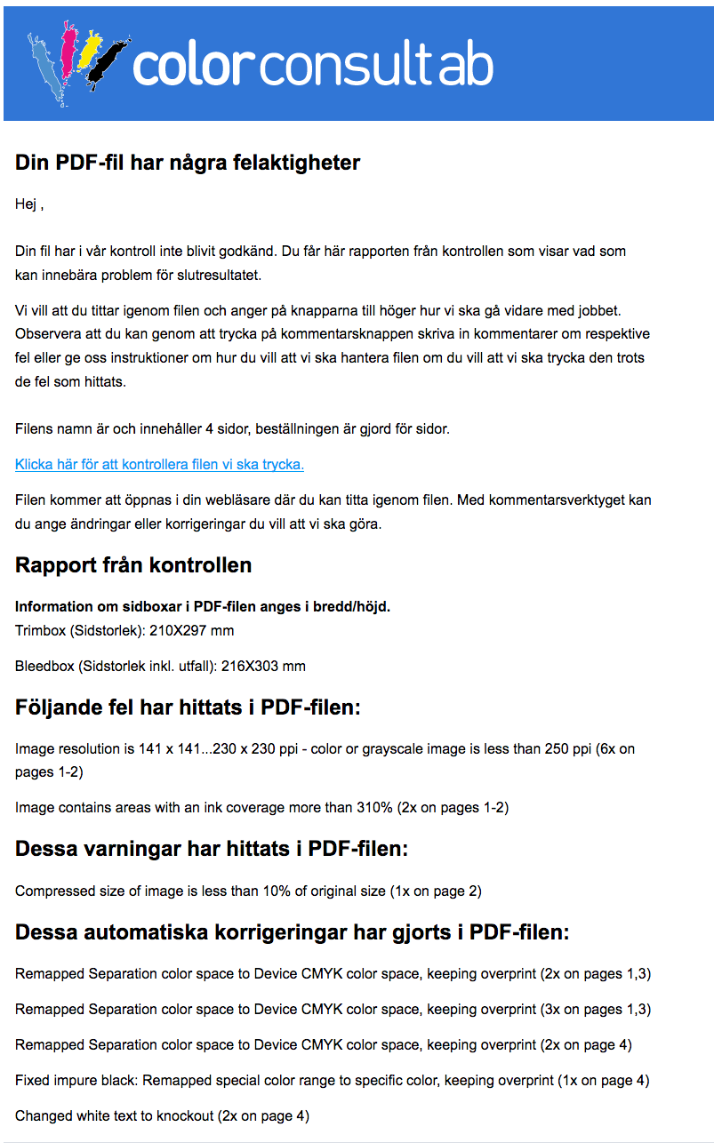

I must be missing something cause I am trying to email a report out along with the link to proof the file via PDF Review Module but I can't get the report to send all I keep receiving is the actual file. I can send from pitstop server app in switch and get the report but now from PDF Review Module and I don't want to send out 2 emails, any ideas?

You can save the report as XML that you convert to HTML and include in the email as an Opaque dataset.

Penguin wrote: Mon Apr 13, 2020 9:29 pm I must be missing something cause I am trying to email a report out along with the link to proof the file via PDF Review Module but I can't get the report to send all I keep receiving is the actual file. I can send from pitstop server app in switch and get the report but now from PDF Review Module and I don't want to send out 2 emails, any ideas?
We had the same problem. I solved it by creating a repository-folder that I save the pitstop report to, and then, right before the mail configurator that sends out the link to the review, i added an "inject job" configurator that swaps the pdf-file in the flow to the report instead, and then I could just set the mail configurator to attach files to the mail.

billy.olvestad wrote: Wed Apr 15, 2020 11:52 am We had the same problem. I solved it by creating a repository-folder that I save the pitstop report to, and then, right before the mail configurator that sends out the link to the review, i added an "inject job" configurator that swaps the pdf-file in the flow to the report instead, and then I could just set the mail configurator to attach files to the mail.
The whole idea with PDF Review is not to send files to customers with email. One simple and dirty way is in that case isto merge the job file with the report file to one single file and then run that one through PDF Review.

by jan_suhr
This is better and give the information needed. :D
What you get for errors, warnings or fixes depend on what your profile is checking for.

Thanks for the help with the inject that seems to work but now I've created a new problem which still causes me to send 2 emails. Once I put variables in my html to email it gives me the information about the report not the file that was preflighted. Is there a way around that? These are the variables I'm using.
Pages: [Stats.NumberOfPages]
All pages same size:[Stats.PageBoxesEqual]
Height: [Switch.Calculation:Expression="[Stats.TrimBoxHeight:Type="Defined"]/72"]
Width: [Switch.Calculation:Expression="[Stats.TrimBoxWidth:Type="Defined"]/72"]
Transparency used: [Stats.TransparentColor]
Colors: [Stats.Colorants]
Re: PDF Review Module

Penguin wrote: Tue Apr 21, 2020 5:23 pm Thanks for the help with the inject that seems to work but now I've created a new problem which still causes me to send 2 emails. Once I put variables in my html to email it gives me the information about the report not the file that was preflighted. Is there a way around that? These are the variables I'm using.
In this case you will have to save out the stats to private data variables before doing the swap with inject job, and then reference those variables in the mail instead.
