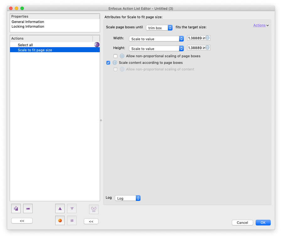

Then in PitStop Server you'll need to make an Action List with the 'Scale to fit Page Size' Action (see below)
and using a variable you drive it with the values for the required.
That will then resize the page and page boxes to the required values and the content as well.
Hope that helps.

Make an Action List like this.
Will do what you want, only decision is if you use the Trim Box or the Media Box.
You just have to do it manually instead of automatically in Switch.
Screen Shot 2020-04-08 at 7.36.05 PM.png (103.98 KiB) Viewed 10726 times
