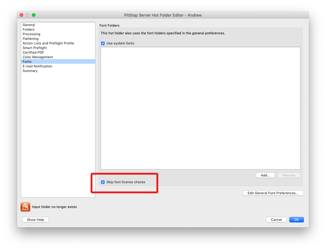

If you have fonts that you think you should be able to outline, but they are not working, this maybe down to font licensing restrictions.
You can override the licensing in the PitStop Server Hotfolder preferences (see below, not the global preferences) and in the Switch Configurator.
You should of course check your font license agreements before doing this.
