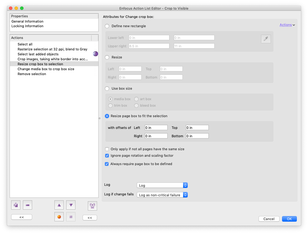

Maybe first to explain how the crop to visible works.
Firstly it selects everything you want to crop to, in this case everything (all)
Then it makes a grayscale image (32dpi) of that content as a copy
Then it crops the white edge pixels away from that image
The the Crop box is resized to the bounding box of that image.
Then the Media box is resized to the size of that Crop box.
Then the grayscale image used for all of this is deleted.
Interesting challenge!

Well, it's not pretty but think I've found something that works. Since the boards can't be negative numbers, if we run the box off the bottom, it will keep the bottom measurement 0. Not the perfect way of doing it but the side crops will always align with the elements and the bottom will be 0. A reasonable workaround for now. I've attached so you can see what I've done. Thanks again for your help!
