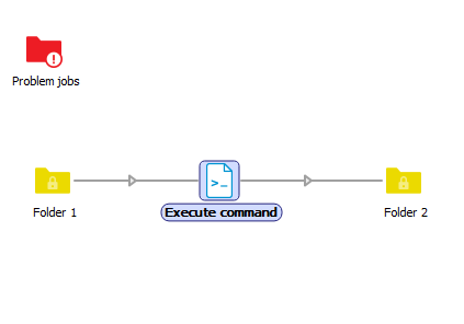

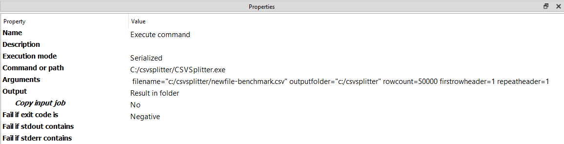

I'm trying to get Execute Command to run the *.exe of CSV Splitter and can't seem to find the right arguments. I always have problems with this applet and there is no good documentation for it. I've read the Help and it doesn't really go into specifics on *how* you can get the arguments to work, use of the variables (%1, etc..) and how to use Switch variables in it.
Here is what I have:
I would really like to be able to split a file that I put in the incoming folder and have the output of the program go into the outgoing folder, since I will need to work with them some more inside Switch. But, the above was an example of me just copying the command line arguments from the readme to try and get it to work without an error.
What am I doing wrong?

Yes, I tested the program at the command line and it worked as expected.
I changed the arguments as you listed and made sure that the execution mode was concurrent. Failed, but the logs show an interesting error. The program was trying to access the Switch folder in AppData and was denied. I tried changing the "out" folder in the flow to a non-managed folder, but that did not solve the problem. I think when the program is trying to make it's split files in the temp folder, it's being told by Windows Server 2019 that it does not have the rights. Any idea how to give it elevated credentials?
Also, for other people trying to figure out to use Execute Command, it looks like you use the argument variables (%1, %3) to insert Switch paths into the processing of the job. If you look at the debug log posted, Switch substituted it's own paths for the command line arguments that the program needed to run.

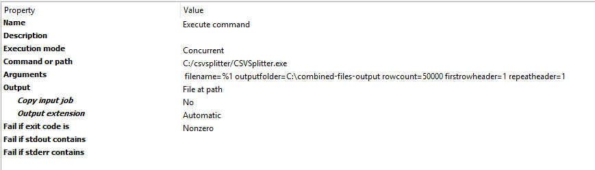

So, after some further testing, it looks like CSV Splitter does not like the really long path required to read from and send to files inside a flow. I tested the app at the command line and tried to get a result using files inside the flow's backing folders and received the same error in the Command window that showed up in the log.
That led to some playing around with various setting for the arguments and the output setting. What finally worked was the following:
The attachment Working-settings.PNG is no longer available
I had to set the incoming and outgoing folders to locations outside of the Switch internal paths, which finally yielded results from CSV Splitter. I just linked the "output" folder to a new Switch-managed folder as next in line to keep them moving in the flow. Had some odd file names, though. See next screenshots. Padawan, would you have any other ideas on how to get it to work without having to use external folders?
