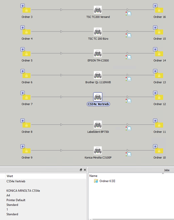

The Flow with the app looks like this:
Bildschirmfoto 2020-07-08 um 13.29.00.png (154.02 KiB) Viewed 21467 times
For some printers it works very well for some not, Switch brings up an Error Message that some ScriptExecuter....exe crashed.

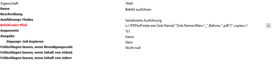

I also found a similar tool to ghostgum its called pdftoprinter http://www.columbia.edu/~em36/pdftoprinter.html.
Sending print jobs to a printer via cmd is easy, there is no pdfreader poping up now its completely silent.
But its also possible to define the amount of copies to print, the printer and the file as variables. But how can I build this in execute command?
My files are named like YB27_bkromer_copies_2_BP730i.pdf and the command should look like
c://pdftoprinter.exe c://hotfolder/input/YB27_bkromer_copies_2_BP730i.pdf  "BP730i" copies=2
So I need the variable [Job.Name:After="copies_",Before="_"] for the amount of copies, the [Job.Name:After="_",Before=".pdf"] for the printer name and the [Job.Name] for the pdf file to print.
Is there a way to make this work?
Bildschirmfoto 2020-07-22 um 10.24.33.png (66.38 KiB) Viewed 21317 times
If this works, this would be the perfect solution.

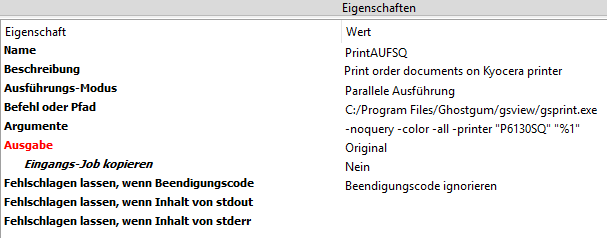

when using gsprint (blazing fast, no size mismatches) you can use all those switches (including copies):
http://www.ccp14.ac.uk/ccp/web-mirrors/ ... sprint.htm
Simple implementation screenshot:
Cheers,
Ralf
