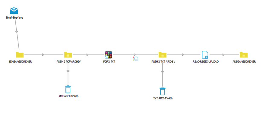

Hello,
I have this flow:
Bildschirmfoto 2020-07-17 um 13.07.23.png (41.24 KiB) Viewed 31203 times
In the Flow I get a PDF-File from Email convert it to text search with regex in the text.
When I work with the File i always use File.read(job.getPath(), 'UTF-8'); wich gives me the incoming file wich is the txt-File.
Now I also need the PDF from the beginning, how can I select this?
I want to upload it to an API with theHTTP.setAttachedFile(job.getPath() , filename); ...
Thanks in Advance for your Help! :)

You have to branch out before the text conversion so you get a copy of the PDF. Then you can upload that one.
The PDF you convert to text is sent to null after the conversion.

okay, I have this PDF ARCHIV 48h trashcan in there, where all the incoming PDF are archived for 48 hours.
Is there a way to select the belonging PDF-file in the script, some job.get... function or similar?
Re: Select a file from the beginning of a flow
Posted: Fri Jul 17, 2020 2:36 pm
by jan_suhr
Branch of to one folder before the pdfToolbox element and then from that folder back to the folder before the script, then both the PDf and the TXT will be going in to the script. In the script you have to pick up both the PDF and the TXT file.

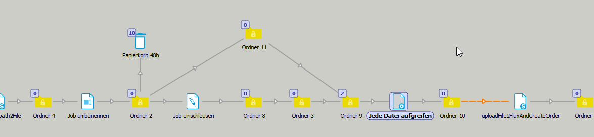

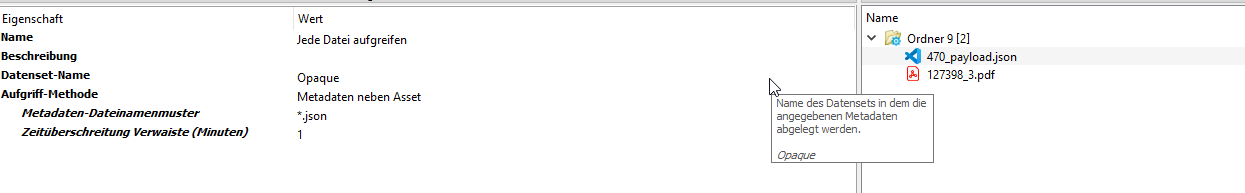

For Example I have this flow where I want to opaque pickup a *.json file in a *.pdf file but it stucks before the pickup flow element.
Why is that? :?:

Do both files have the same name?
Posted: Sun Nov 15, 2020 1:26 pm
by bkromer
jan_suhr wrote: Sun Nov 15, 2020 11:05 am Do both files have the same name?
No its 470_payload.json and 127398.pdf as u can see on the screenshot.
Posted: Sun Nov 15, 2020 1:52 pm
by jan_suhr
Sorry I didn't see that.
But that is your problem. For the Pickup tools to work with the setting "Metadaten neben Asset" both files have to have the same name.
So you have to find a way to rename the payload file.

Is it not enough to rename one of the files? Image
They still have their unique filename for a second.
Posted: Mon Nov 16, 2020 9:59 am
by jan_suhr
You renamed the payload file and also changed the extension. The filename before the extension must be alike but different extensions. The filetype you want to embed as an opaque datatype i specified in the properties.
You you need two files as this: myfilename.pdf and myfilename.json
