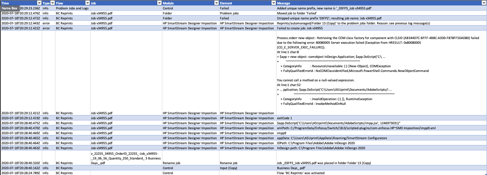

We're having a unique error when trying to impose PDF's through Switch. I have attached a logo below. Essentially, InDesign/Smartstream seem to be throwing an error when trying to run jobs through Switch. Below are the app versions for reference.
Error Log.png (181.56 KiB) Viewed 31465 times
Any help would be greatly appreciated.

i ran into the exactly same error in a similar setup.
Is there any working solution to fix this?

We are also getting the same error. Smartstream Designer is unusable via the Switch configurator with the latest version of 15.0.6 Smartstream Designer installed. I did notice in the release notes of 15.0.6 that this version was supposed to 'fix an issue with Switch'. Maybe that issue still exists? We are using Windows PC Switch and Indesign.
