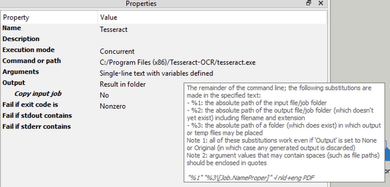

I've automated Tesseract before.
It indeed has the limitation that you can only input jpeg files, which makes that you can't input multipage PDF's. However, you should be able to build a flow which solves this without any scripting:
- Input folder where multi page pdf's are dropped
- Remember the original filename and the amount of pages in private data
- PitStop PDF2Image (or another tool) to convert the PDF to jpegs
- OCR the jpeg's via tesseract
- Use an assemble job with custom scheme. Job identifier is the original PDF filename which is stored in private data and the amount of files is the original amount of pages which is also stored in private data
- Use Merge PDF to merge the PDF's
Output should be a multipage OCR'd PDF.
These are the execute command settings I have:
Screenshot 2020-07-31 at 12.02.43 copy.jpg (91.85 KiB) Viewed 24698 times
Switch is more a build-it-yourself solution instead of an out-of-the box solution. There is more effort required compared to out of the box solutions, but it can do so much more. That's what makes it so awesome :)
