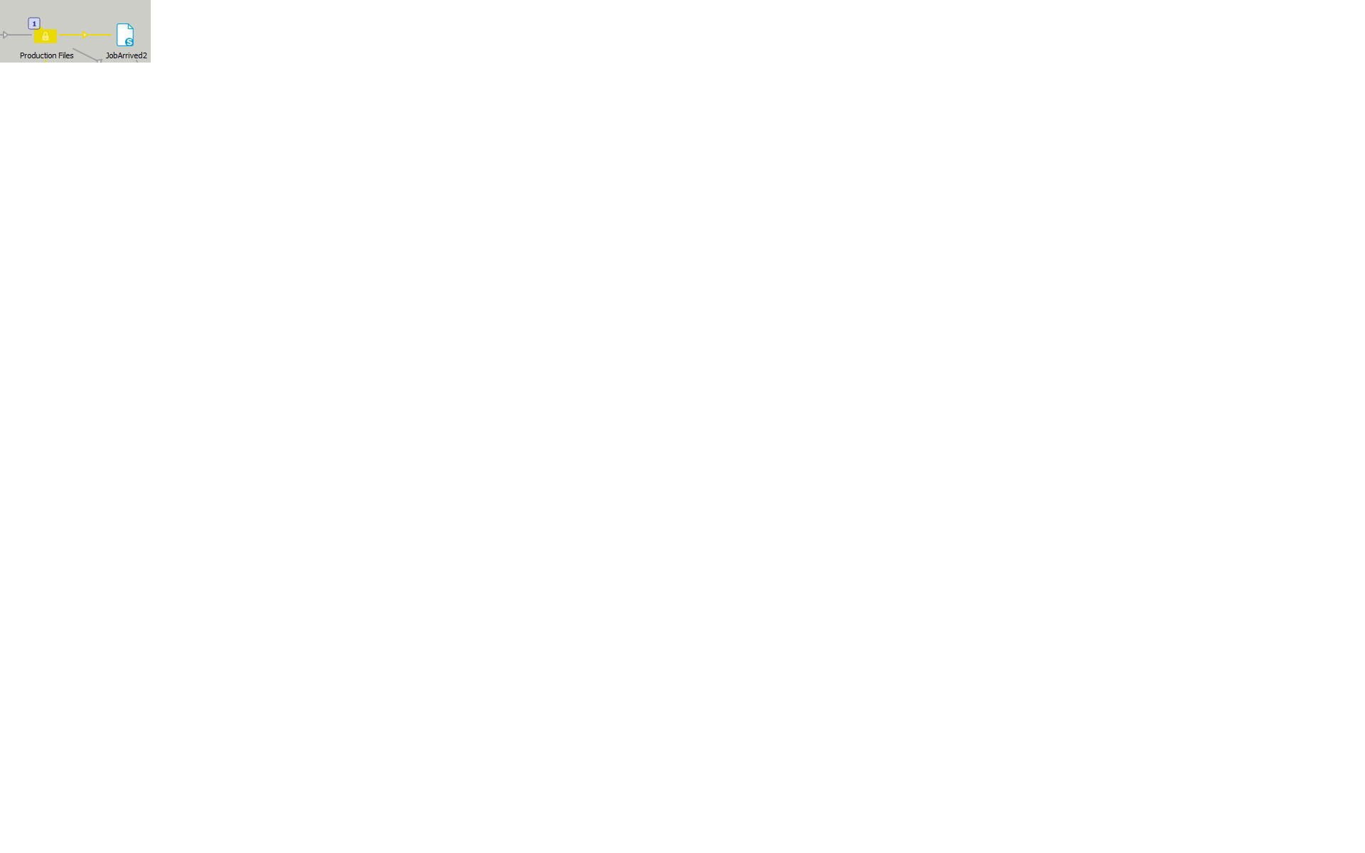

i want to know how can i strat debugging a flow in vscode or better to say how can i debug one script flow in vscode

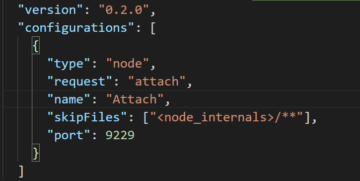

i set debug mode yes and port 9229 and by vscode in launch.json this setting

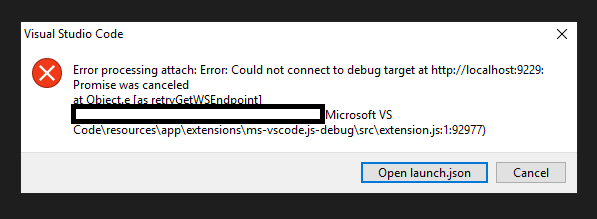

i active the flow and press F5 for debugging, but occurred this error :
could anyone tell me what should i do or clearly explain how to do it. there is not good information in documation

These message show-up when VsCode didn't get a return from switch.
There is three main cause :
- Switch flow element is not set-up in debug mode
- Switch flow is not running
- You already done a debug and did'nt restart your switch flow between.
But i agree on that, the documentation is a bit unclear for this process

i have done everything and still i get the error

Is there any error in the messages?

Make sure you have the document/file in the folder proceeding the script befofe you start debugging
Re: NodeJS debugging
Posted: Fri Aug 21, 2020 7:07 am
by Sunnyland
Make sure you have the document / file in the folder proceeding the script before starting in debug mode.
and start the debugger in attach.

Sunnyland wrote: Fri Aug 21, 2020 7:07 am Make sure you have the document / file in the folder proceeding the script before starting in debug mode.
Tnaks for your response, yes that was the reason
one file must be in flow
