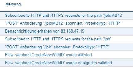

The messages from my test script.(read from bottom to the top)
Bildschirmfoto 2020-09-28 um 16.09.36.png (61.37 KiB) Viewed 44548 times
The first path "/job" is subscribed and the second one with "/job/MB42" but if I now try to POST another json on that new webhook ("/job/MB42) nothing happens.
So how can I continue with the second WebHook do I need a second WebHook Triggered function?
