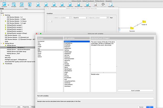

In this case we are going to use the file size, so you would have two routes in the workflow, one for files -10mb, one for files +10mb.
Below is a screenshot of the variable you need for routing on the file size.
If you look at the documentation, you would need to route on 'Define Condition with Variables'.
