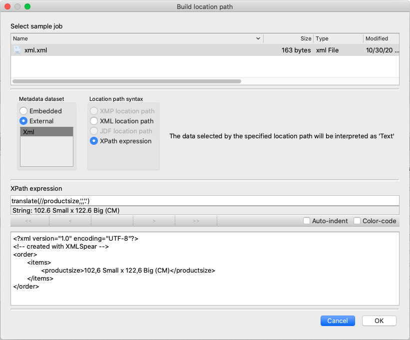

Hello,
I would like to replace commas by dots in the "productsize" node to get this result: "102.6 Small x 122.6 Big (CM)"
Below, my xml example:
<order>
	<items>
		<productsize>102,6 Small x 122,6 Big (CM)</productsize>
	</items>
</order>
Do you know the function to do this? Thank you ;)
Posts: 1184
Re: Replace comma with a dot
This is something you can do directly in the XPath with which you get the info from the XML using an XPath function:
Screen Shot 2020-10-30 at 15.35.00.png (76.96 KiB) Viewed 36613 times
The XPath expression is perhaps not so readable in the image:
translate(//productsize,',','.')
