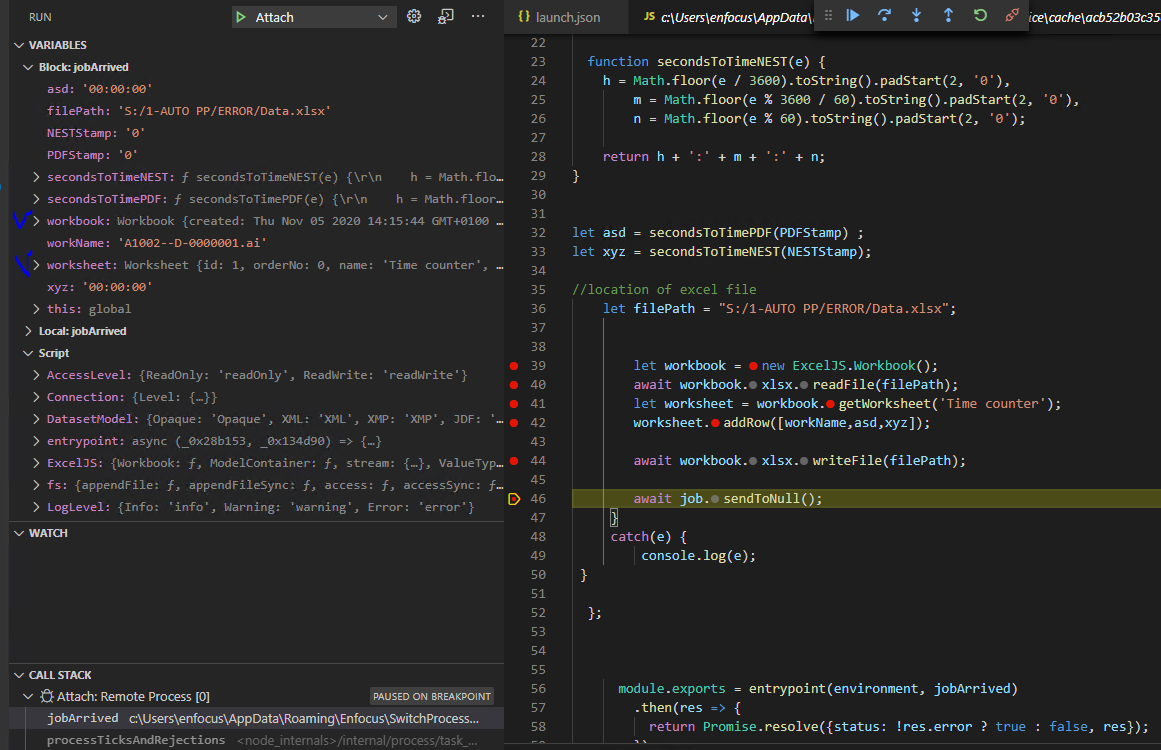

From debugger the excel function skips the last three rows and goes directly to job.sendToNull. is this a sync function error? I changed the function a bit.

Changed my code, but data is still not appearing. In debug, all variables seem to be correct?

No errors are logged into Switch.
Running the script in switch takes about 15 seconds from script activation until receiving processing finished, is this normal? Tried using another excel file, then it went down to 1 second.
Tried with a table from the server and also on the local disk, neither did work. I also tried to use sheet id, instead of name which also did not work. It does save the excel file, i can see that by the timestamp, but the data is not inserted.
When i run the same script in node, without Switch functions, everything works just fine.
