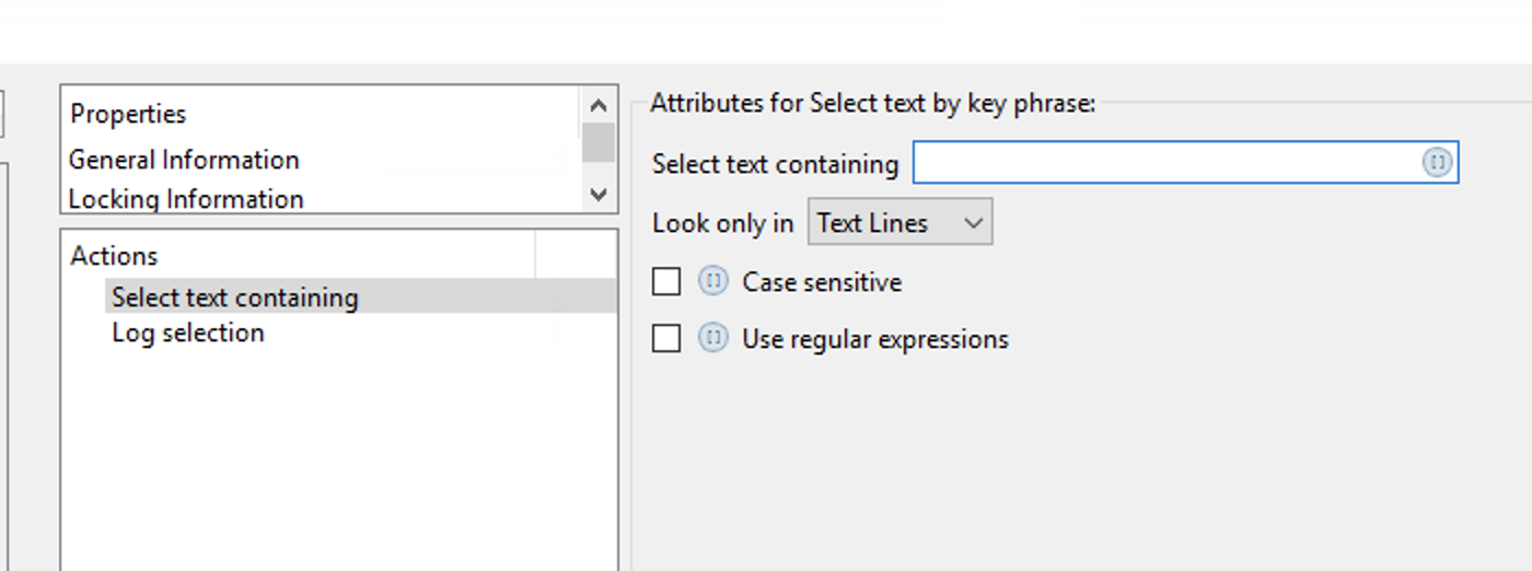

Did you get a resolution on this? I am trying to do something similar, where I need to use PitStop to read some text in the PDF then get Switch to push it in a specific direction.
Martin

There is an option to 'Select text containing' in Pitstop. Then you can log selection as warning.
For routing the file you can use the Pitstop XML-metadata or the orange warning outgoing connection.
You can use a Switch variable if your specific phrase is variable.

Posted: Wed Aug 23, 2023 10:53 am
by mpeapell
Thank you... this is perfect!
