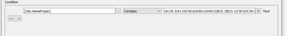

I have a connector, which has Conditions in variables defined to the "Include these jobs" option.
Currently, i have created a new condition for each new "ID" of a model. This creates a very long list of conditions.
Can i wrap it up in a single condition( Capture 2), which uses regexp? I tried, but it does not seem to be working. Am i doing something wrong? Can i even do this?
