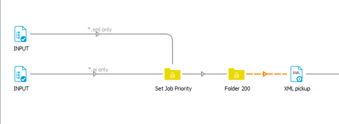

Changing the minimum file solves the big file problem, but creates another one. I also have xml files coming into that folder, which sometimes are smaller than 1kb. If i set the submit hierachy with minimum file size 1kb, the xml files are not picked up.

You can split the flow to run only the XML-files through another Submit hierarchy element.

Submit filespec does not allow to use network folders. Can you please explain how to run XML files through another submit hierarchy?
When i try to use the same submit hierarchy twice, the ai file is moved to problem jobs.
Maybe it's simpler just to move the xml and ai to separate folders with my script.
