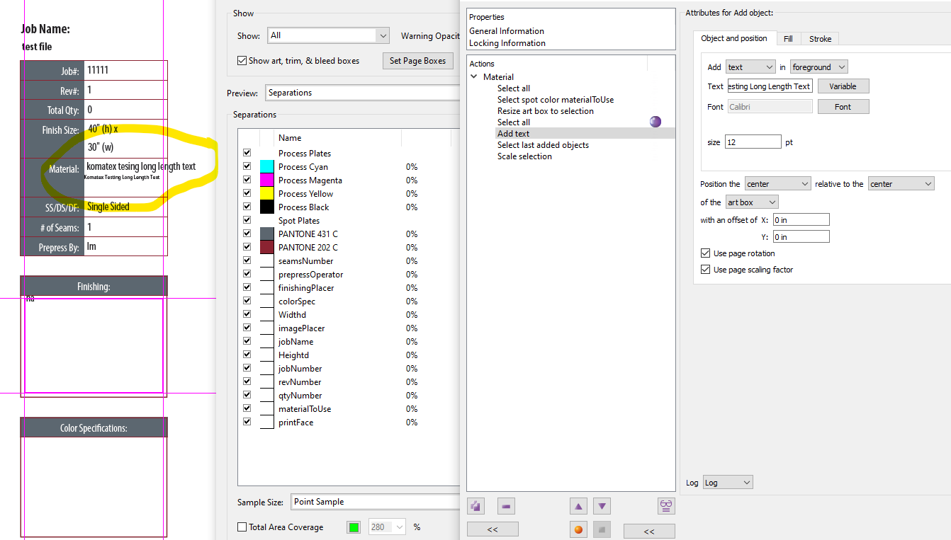

I have a proof sheet that we are adding variable data too. And there are times it will need to wrap, into the box. I was able have it shrink, but this isn't what I am looking for. Is there another way to do this?

Not at the moment Liv, it's just single line

That is a much needed feature!
Until then a workaround could be to use variables. If you know, that there is room for maybe 20 characters pr. line, you could define character 1-20 of the sentence as one variable and character 21-40 as another variable and then place the second variable beneath the first variable. You will need Switch to configure this.
