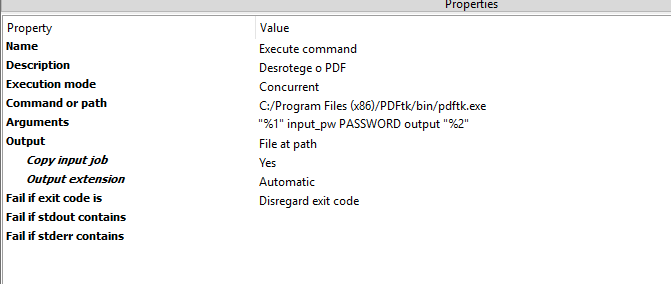

You can use the following values do set PDFTK in your Switch workflow.
Just replace the PASSWORD with your password.
Screenshot 2021-08-12 at 17.14.05.png (35.11 KiB) Viewed 13414 times
