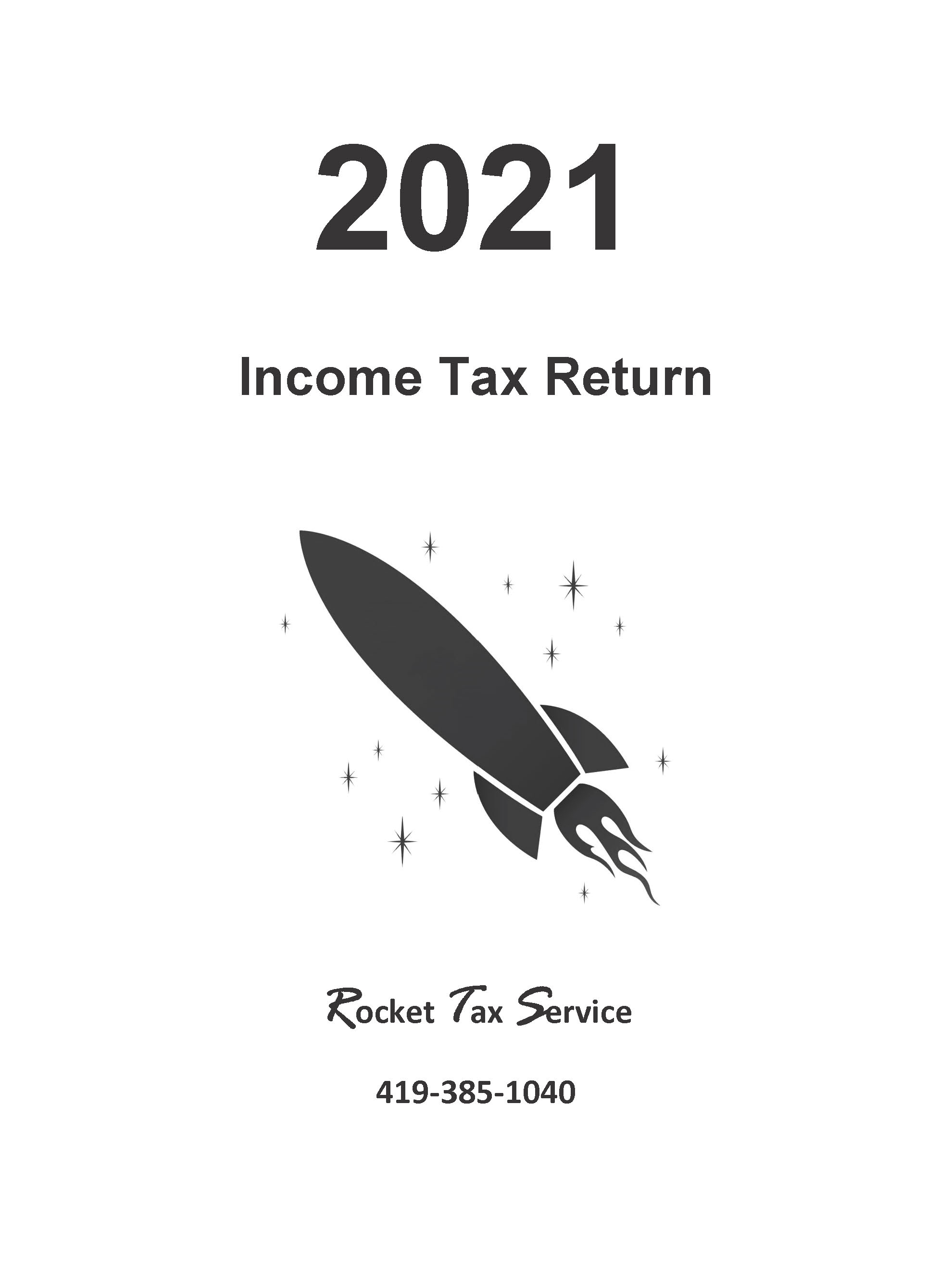

I want to convert a raster image in a pdf file to a pantone color. Not having any luck. I end up with a screened background.
Hope someone can give me a solution... or a step by step process. I am attaching the file I want to convert to reflex blue. I tried to attach the pdf but was warned it was invalid. Converted it to jpg.

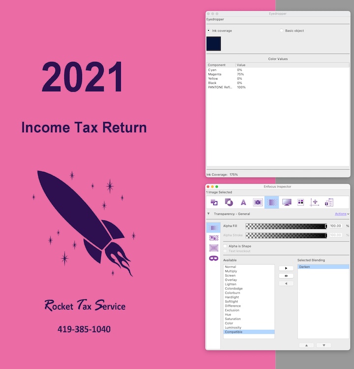

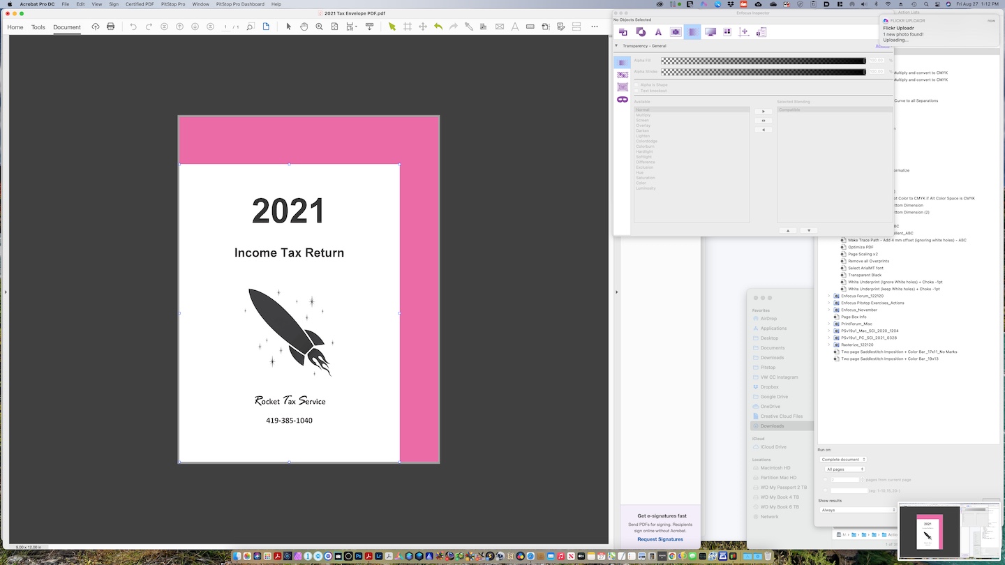

Well, using the above example to change the black graphics to spot changes the color as intended but you cannot add a background color to it, actually you can but its behind the white background. Please download the "Rocket" file.abailescollins wrote: ↑Fri Aug 27, 2021 11:50 am So to clarify, you want to trace an image, fill it with color, and also add a background?
Sounds straightforward. Do you have a test file at all?
I also can draw a square box over it and multiply to get the look but than there is a spot over (Spot not knocked out) my 4C background which is changing the spot color.
- Screen Shot 2021-08-27 at 1.12.24 PM.jpg (182.57 KiB) Viewed 61370 times

If you are playing with Blend Modes, try 'Darken"
I'm assuming that will let the magenta through, and hoping the black will knock out!

I'm guessing there isn't a way for Pitstop to select the white area of a color or grayscale image. Everything I try will just change the "image". I guess I need a photo editor to achieve what I need.Thanks.

Nope, did you try changing 'Multiply' to 'Darken"?
abc@imposition.com
abc@imposition.com
CruzinCooler
- Member
- Posts: 73
- Joined: Wed Aug 11, 2021 6:31 pm
Re: convert raster image to pantone color
Same result. The spot color is pretty much doing what the "Multiply' is doing. It's just adding the background color below the spot color and not knocking out the spot. The sampled area is from the rocket.
