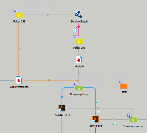

Something still isn't quite right. I set folder constraint to 1 on both outgoing connections of the hold job element. I also set the target folder to the same folder( Timestamp Input) on both connections. But it seems switch still moves jobs cyclically between the 2 connections eg when the first Switches illustrator input folder is empty, Switch still sends it to the second Switch. Am i missing something here, or is it supposed to be like that?

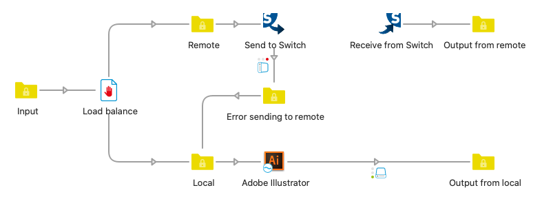

There is no need to set a target folder and the second Hold job element is not necessary. This is the principle:
Screen Shot 2021-05-10 at 11.39.57.png (27.25 KiB) Viewed 125768 times

Are you sure you set the folder constraints on the outgoing connections?
Put the connections after Local and Remote on hold and place 5 input jobs in the input folder. The folders should each get 1 job and there should be 3 jobs waiting before "Hold job". Release one of the two connection and see what happens. The released folder should now get a job after the previous one was processed and the number of waiting jobs drops to 2. If that is not the case, then there is something wrong with the settings. I have used this method often enough to know that it works.
Put differently, the number of jobs in Local and Remote should never be higher than 1 (unless the sending to the remote Switch fails and it is diverted to the Local folder, which you could potentially handle with an extra "Hold job" as you had it in your flow).

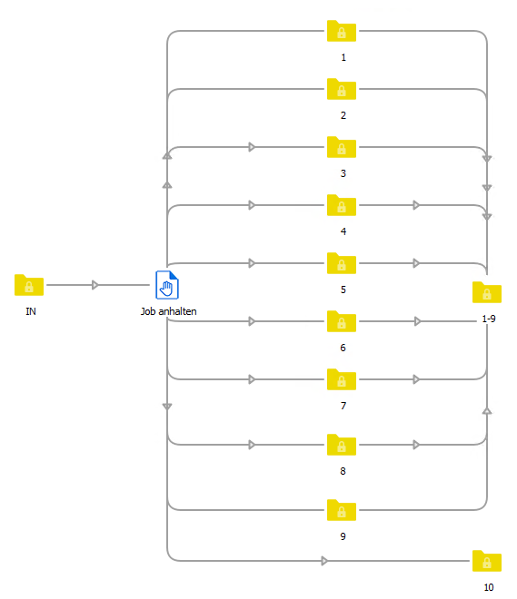

We now have the following requirement: we want 9 jobs send to the first outgoing connection and every 10th job to run in a second connection.
I.e. jobs 1-9 go into folder 1 and the 10th job into folder 2. Jobs 11-19 then go back into folder 1 and the 20th job back into folder 2. Is this easy to implement?
Our idea was to provide the hold element with 10 output connections and to merge the outputs 1-9 back into one folder. This means that we end up with 2 target folders ("1-9" and "10" - see the screenshot). Basically this works, but it looks a bit wild and perhaps it could be configured a bit more streamlined.
Do you have any ideas?
Thanks in advance!
Peter
Every 10th job.png (27.6 KiB) Viewed 110765 times

What about using "Assemble Jobs" upfront and group them by an arbitrary count of 9.
Once assembled, send them through to the "Hold job" with cyclic.

I believe that the first problem is that only job packages of 9 are then always packed.
And secondly, all jobs are only forwarded if the number is a multiple of 9. I.e. if, for example, only 12 jobs arrive, 9 are forwarded, but 3 jobs remain in the inbox folder until a further 6 jobs arrive.
