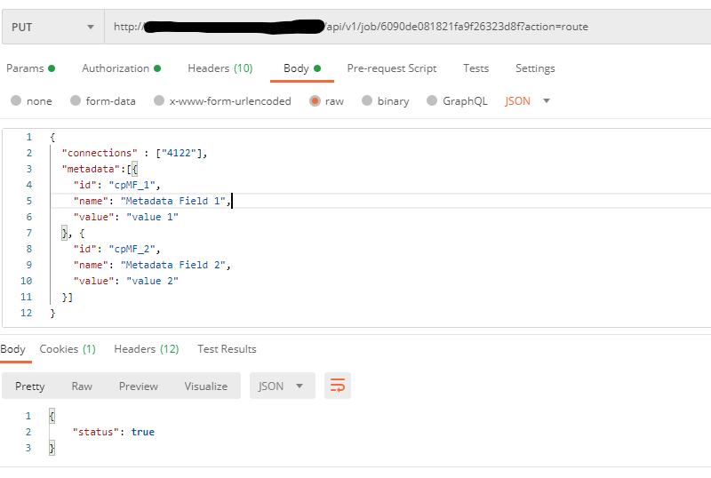

I used the job id as returned in the List Jobs call. I also get the connection number from the List Jobs call. The weird thing is that it was working in the 2019 version. I stopped using for a while as I rebuilt some flows during which I upgraded from 2019 to 2020. Now I cannot get the api to function correctly.
This is my PUT statement - http://url/api/v1/job/6090de081821fa9f2 ... tion=route
I did just notice that I do get an error in messages.
Failed to execute the task 'taskId_202145-18104-c158wg.6s4eg.json': invalid metadata format
Would the metadata be referring to the connection data? The metadata field is optional so I didn't think I had to pass anything?
Screenshot 2021-05-05 093733.png (30.97 KiB) Viewed 14534 times
I have tried with and without the metadata as "connections" is the only required field but I am getting the same result.

When a checkpoint does not define metadata you do not have to specify the metadata field. In that sense it is optional. But when the checkpoint specifies metadata you have to fill it in. I could easily reproduce this using the Web Services documentation: it worked, then I added a field of metadata and I got the same error as you do.
I will report it that the documentation should be explicit about this.

that really helps. I have metadata but it is read only so I didn't bother to specify and the sample I am showing the field names are incorrect so that id why I would be getting the error message.
I don't need the metadata it is only there to help debug so will turn off for now. Thanks heaps for your assitance on this.
