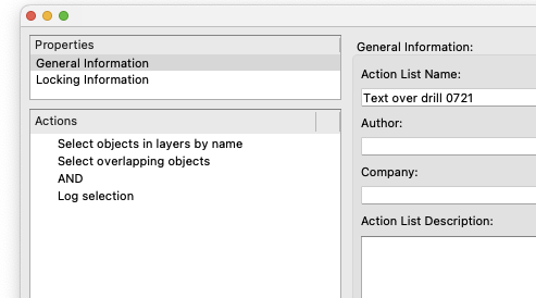

It'll depend on how your file is constructed, ideally the drill marks are on a layer called drill**
You then make a new action
Select objects in Layer drill etc as per the grab
Log selection is set to error

You will probably need to add
Screenshot 2021-07-24 at 13.14.46.png (7.02 KiB) Viewed 8805 times
So that it's only text overlapping that errors.
