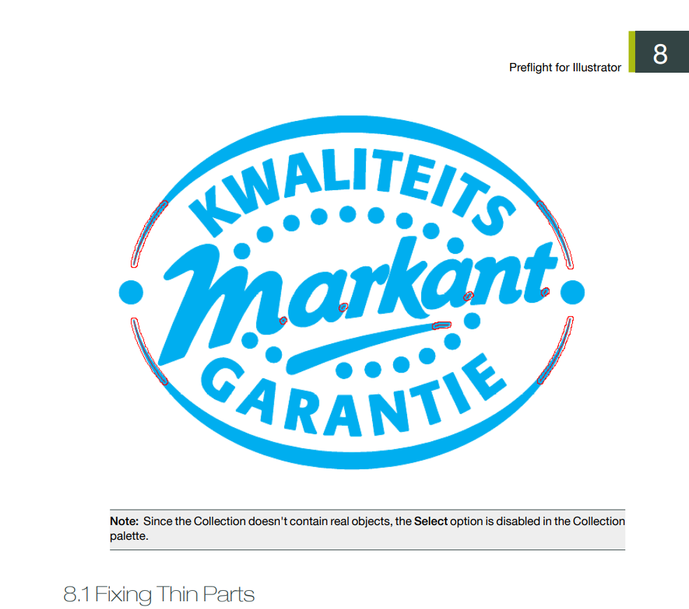

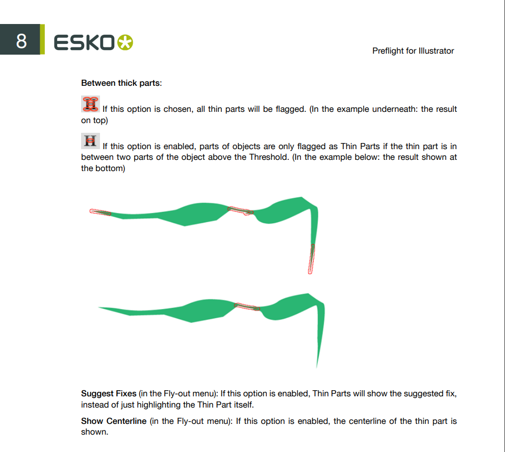

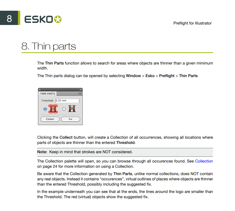

Do any of you know of a Preflight feature that is comparable to the ESKO Illustrator preflight?
More specific the Thin Parts check that allows to search for areas where objects are thinner than a given minimum width.

There's nothing like this in PitStop that finds thin parts of an object.
You can check for thin lines and fills, but nothing like this.
