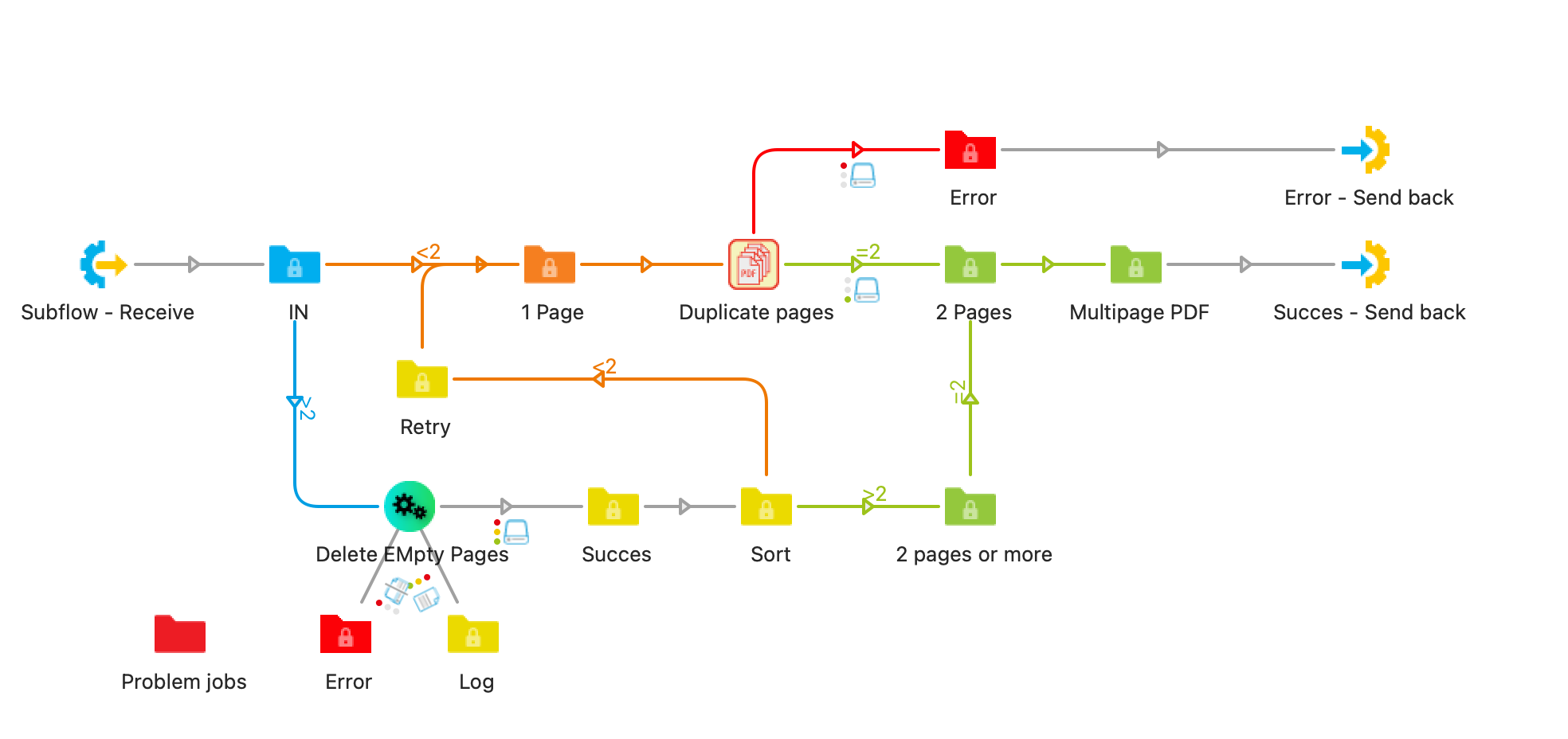

Does anyone know of an action
Duplicating pages of a current pdf file?

Search for "duplicate pages" on the Enfocus Appstore.

If you want to do it in a PitStop Action you have to add blank pages and then copy and paste the content to the new pages.
You can find videos showing this on the Enfocus e-learning platform

Indeed, look for Duplicate Pages in the Appstore. I use Duplicate Pages to prepare PDF files that need to be printed double-sided in a Subflow.
