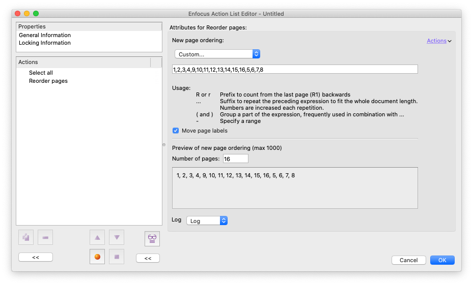

Should it be possible to use the Reorder Pages action to set a file up with pages for multiple saddle-stitch pages to impose correctly? For example a file with 2 8-page saddle-stitch books would be re-ordered from:
1,2,3,4,5,6,7,8,9,10,11,12,13,14,15,16
into
1,2,3,4,9,10,11,12,13,14,15,16,5,6,7,8

Reorder pages should just put them in the order you define.
Should look like this, and you see the resulting page order below
Screen Shot 2021-10-07 at 5.23.49 PM.png (97.98 KiB) Viewed 4380 times

If the previous action was "split pages in half", then "reorder pages" tends to be bugged.
I made a quick test with the expected sequence: 1,2,3,4, 9,10,11,12,13,14,15,16, 5,6,7,8
After "split pages in half" i am getting : 1,2,3,4, 8,10,11,12,13,14,15, 9,5,6,7.
The "9" somehow jumps after "15".
