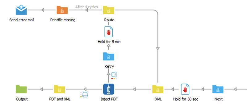

Did you try the Inject Wildcard app? I created this flow a few weeks ago. If file don't exist it will retry job 4 times á 5 minutes. Then an error mail is sent. Would this work for you?
- inject_wildcard.png (46.42 KiB) Viewed 94275 times
