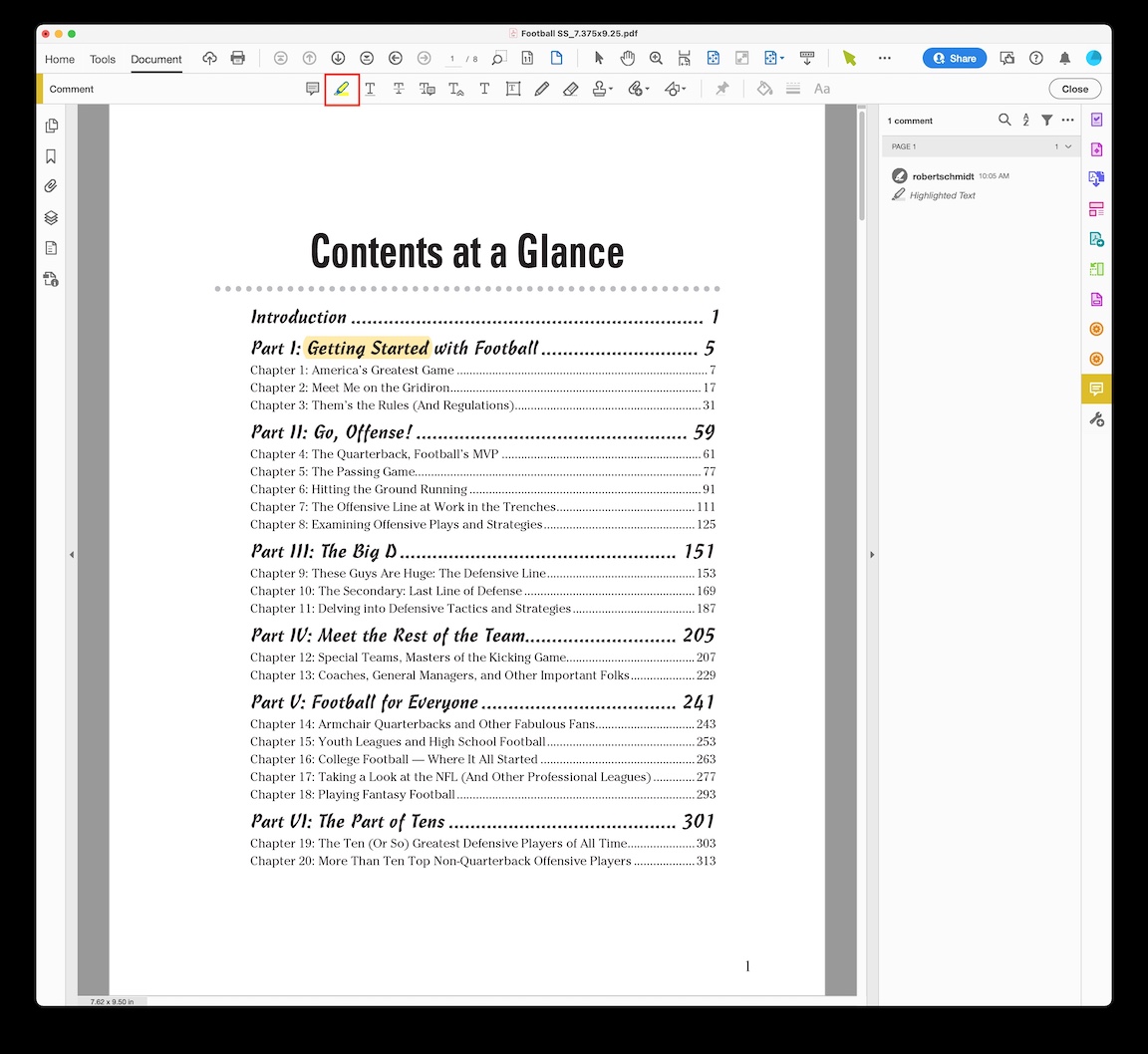

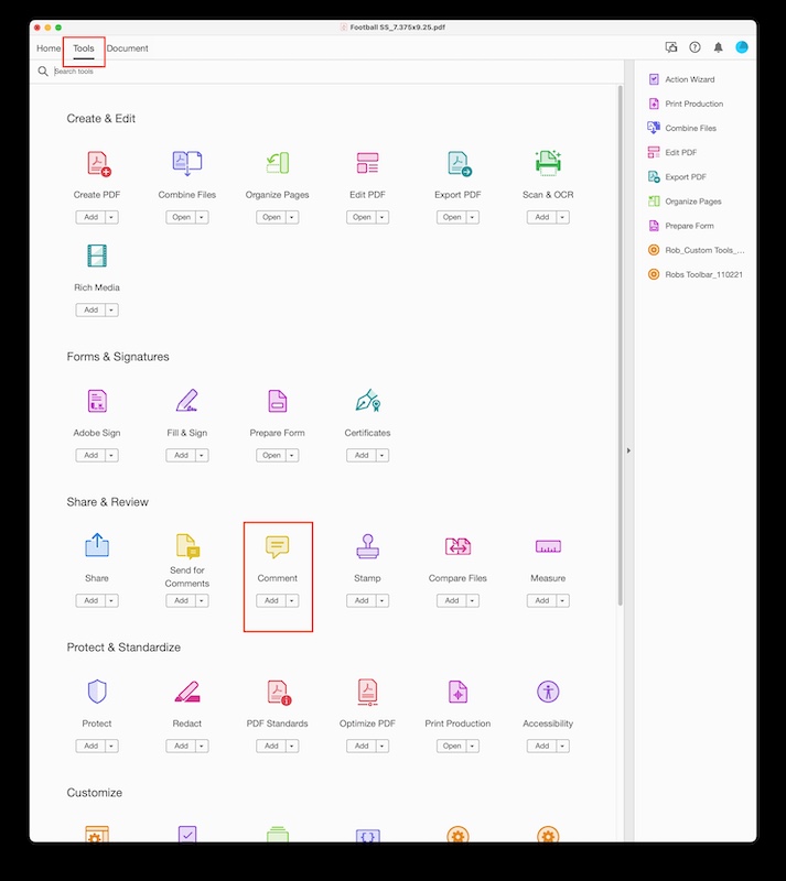

Steve-O wrote: Wed Feb 09, 2022 11:15 pm I have a pdf file that has orange like highlighter on a line of black text. I can select the text and move the text off of the highlighted orange behind the text. I cannot select the highlighter type color after I have moved the text line off of the color. I have never seen an element that could not be selected in a pdf. Who can give me a hint ? Is it possible the color is on a locked layer? I would upload the file so that you can see my issue but I have not figured out how to properly discern the secret for attaching files.
Steve Robison
Open the Tools > Comment palette. Select the Highlite text tool and from there you can right click and delete it. See attached screenshots.
2 Select Highlight text tool and right click to delete.jpg (246.24 KiB) Viewed 8513 times
1 Select > Tools > Comment.jpg (84.57 KiB) Viewed 8513 times
