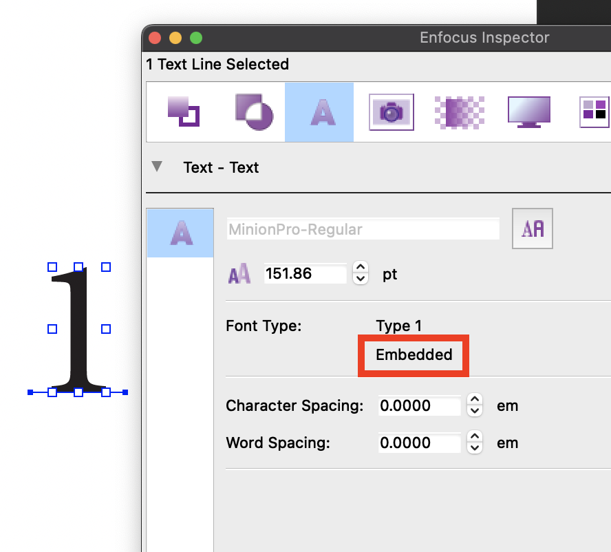

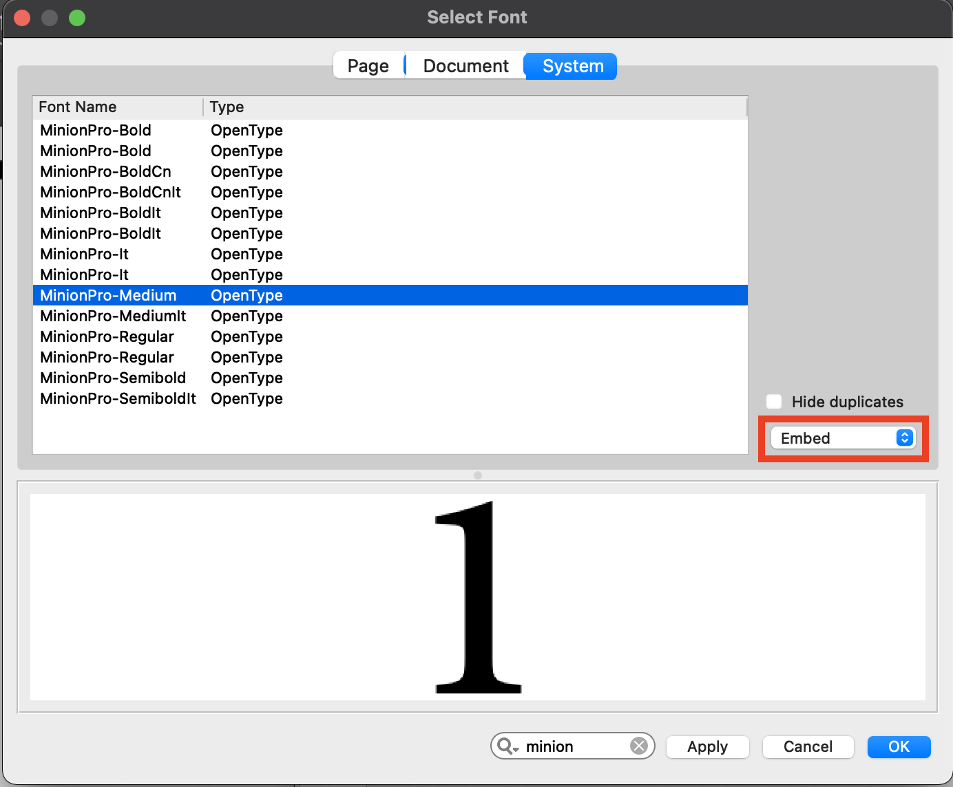

The fonts installed on your system will always be full fonts. It's just that when applications create PDF's they sometimes don't put all font glyphs in the font version inside the PDF file.
If you replace the font of the selected text using PitStop Pro to a new font and you make sure the settings are set to embedded, then it should be fixed.
This looks like this:
(It might be different on your system since your screenshot suggests you are using an older version of PitStop Pro)
Screenshot 2022-03-03 at 13.51.58.png (171.98 KiB) Viewed 4711 times
