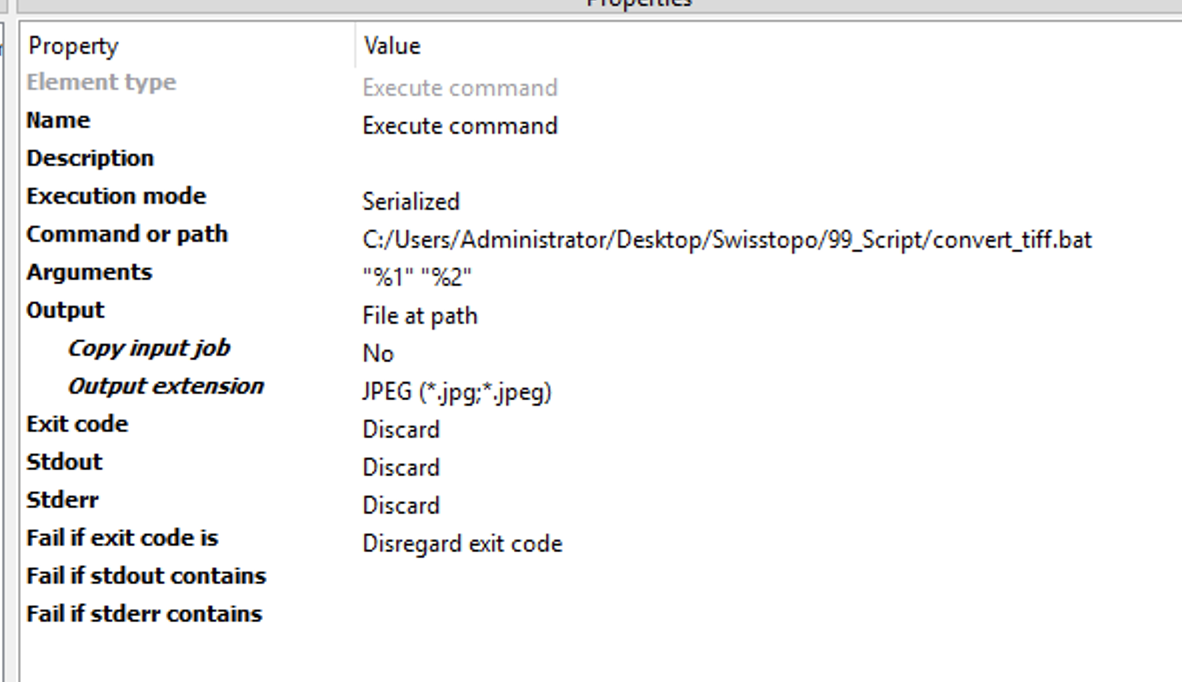

I've been having issues lately with ImageMagick on Windows Server. Whenever I try to convert anything, the following error is displayed in the messages:
Cannot send job: path 'E:/Enfocus Switch/temp/1/ScriptElement/109/7/ExecuteComandResult/[i]filename[/i].jpg' does not exist
I've attached a screenshot of my config of the execute command element. It doesn't matter what the inputs and outputs are. Neither PDFs nor image files work as in or outputs. It also doesn't work if my command is simply "%1" "%2" and a output extension that differs from the input extension. Weirdly enough, the exact same flow works perfectly fine on macOS (Big Sur) and works for image files on a Windows 10 PC (not PDF files though). Nothing works on the installation that matters, a Windows Server 2019.
Any help is much appreciated.

My advice here is to place everything in a BAT file and in "Command or path" you browse to the BAT file. Below is something from an old BAT file I used that you can easily modify to suit your needs.
"C:\Program Files\ImageMagick-6.9.2-Q16\convert.exe" %1 -colorspace sRGB -resize 755X774 %2
The thing I always check because I am never 100% certain is whether or not to use quotes in the BAT file, because on OSX it is the other way around. As you can see from the example: no quotes in a BAT file, quotes in a shell script (perhaps now I will remember :) ).
And also note that the %1, %2 and %3 in Switch are placeholders with a certain meaning, the numbers do not say anything about the order in which they are used. There could also be additional parameters, either hard-coded or using variables. In BAT files/shell scripts the %number is about the order of the parameters. So, do not think that %1 maps to %1 etc. If you used this as the "Arguments" in "Execute command":
"%1" "%2" sRGB
the code in the BAT file would be:
"C:\Program Files\ImageMagick-6.9.2-Q16\convert.exe" %1 -colorspace %3 -resize 755X774 %2

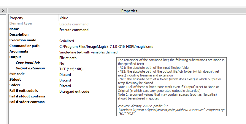

Hi freddy, thank you for your reply. Popping it into a BAT file unfortunately didn't do the trick...
I've got two batch files now, see configuration in the attached screenshot:
"C:\Program Files\ImageMagick-7.1.0-Q16-HDRI\convert.exe" %1 %2
and
"C:\Program Files\ImageMagick-6.9.9-Q16\convert.exe" %1 %2
I installed a different version of IM aswell to see if that would change anything but it didn't. It's also not just on my own installation, the same issue occurs on a client's installation... I can't for the life of me figure out what I'm doing wrong :shock:.

Posts: 1189
Re: ImageMagick – cannot send job
To the bat cave!
First of all, do not disregard the exit code. Check the value in the ImageMagick documentation.
Run the bat file from Command prompt to see what happens. If it does not run there, it will not run in Switch.
Check the debug messages to see what command was exactly executed and see if there are any anomalies that can explain the problem.
Another thing to consider is that the environment in which CLIs are run in "Execute command" is not the same as when you do it in Command prompt or Terminal. The path variable could be different for example, so some dependency could be found in Command prompt/Terminal but not in "Execute command". Add the path to where Imagemagick is installed to the beginning of the BAT file:
set PATH=%PATH%;C:\Program Files\ImageMagick-6.9.2-Q16
Well, with whatever version you want to point to of course. And it is also no longer required to specify the full path when running convert.exe.
