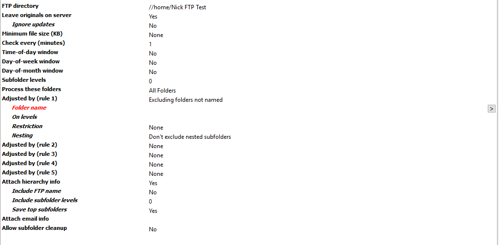

My problem is collecting the files from The Root folder eg "Nick FTP Test" Whih has Multiple Tiltes in but we only need to Recieve the ones requested.
I was thinking "Process These Folders - All Folders" and "Excluding Folders Not Named" Populating the "Folder name " to whatever the path requested is eg "Reprint/Book Series/Book1 or New Titles/Book1 or any other title they need"

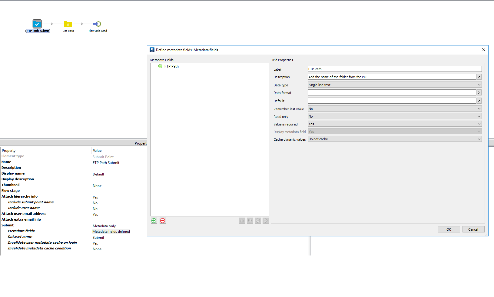

That sounds promising. Any guidance on what the command line prompt should look like would be great. The Submit point I made for this is just a single line text for our in house Sales Team to copy paste from their PO/Email and various other routes.JimmyHartington wrote: ↑Fri Apr 29, 2022 9:24 am I do not think you can get the FTP Receive to do what you want.

- FTP Submit Point.png (36.15 KiB) Viewed 13333 times
