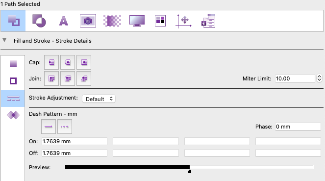

What I can think of is to use the dash pattern functionality of PitStop where you would use a large "on" and a small "off". It may not suit your needs completely: this method does not allow you to specify the number of nicks, that is something you could only achieve if you establish the length of the contour first and change the on/off values accordingly. It will also not be easy to decide where the first dash will start. That is something you can influence with the "Phase" value but again it is not straightforward. For it to work correctly you will have to have a closed stroked contour.
Screen Shot 2022-09-07 at 08.00.04.png (32.78 KiB) Viewed 2259 times

Thanks Freddy, I tried this now and it might be a useful option. Is there a way to "flatten" the dash (dividing the dash into separate objects)?
Posts: 1189
Re: Generating nicks on Die lines
That is not possible. There is a "Convert strokes to outlines" action but you probably do not want the cutting table to start cutting very thin outlines. Or does the cutting table software have a function to convert thin outlines to a single cutting line along the center?
