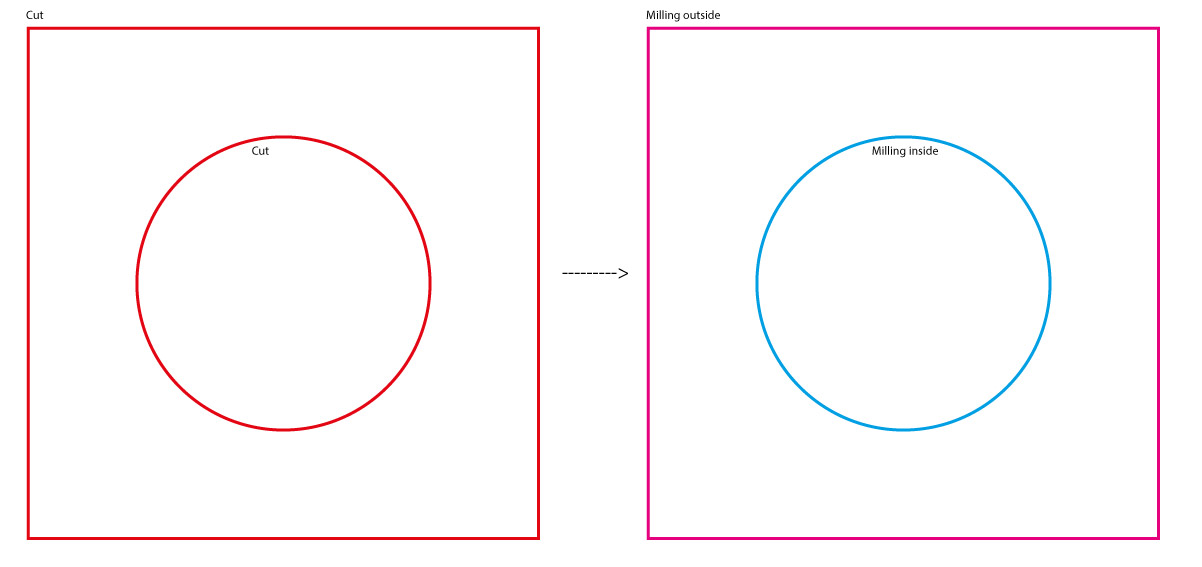

Hello,
Is it possible to select a closed path inside another closed path ?
Below is an example of what I want to do. We receive cutting files of this type (left) and I would like to modify the paths as shown on the right so that the file is ready to be milled (right).
Thanks

You could select the Cut path.
Set artbox to selection.
Select object completely inside region which is the artbox with color cut.
Change color of the object.
If you still get the outside box selected, then resize the artbox to -1mm on each side before using it as a region.

Thank you for this explanation which works with this first example.
Finally, this is what I would really like to do with letters.
Do you have an idea? ;)

I have solution for your example. But it is not perfect.
Action list: https://d.pr/f/2Bej8Z+
As you can see it works.
But only because there is 2 lines.
Since I use the bounding box of all the Cut colored objects there can be situations where a object is completely enclosed in the bounding box.
If I move the object a bit in your example, then it does not work.
Your text in this case was a compound path, so I needed to split the path first to make it work.

I understand. Indeed, when testing on a sample of cutting files, it does not work in all cases.
I am continuing my research. Thank you.

Does it have to be completely automatic?
Our could a user select items and run the action list on user selection?
Because if that is the case then my action list should work, where the user needs to select items where the bounding box will make it work.
It could be done like in this video: https://d.pr/v/1jOWgC
