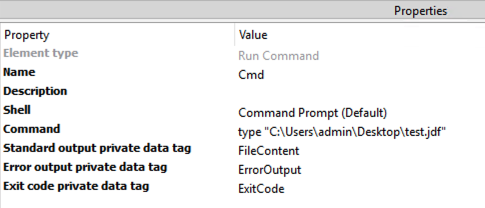

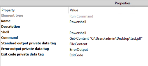

You can use the "Run Command" App to achieve this. You can use either Cmd or PowerShell:
In Cmd using the type command:
Screenshot 2022-12-01 at 08.46.58.png (46.56 KiB) Viewed 21789 times
In powershell using the Get-Content command:
Screenshot 2022-12-01 at 08.47.06.png (46.55 KiB) Viewed 21789 times
The path to the text file can be set via variables of course. The content will be in the FileContent Private Data field.
