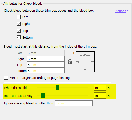

Good morning. I would like to receive support about how to work with the attributes for Check bleed. Please we need information about how the "White threshold" and "Detection sensitive" controls work.

The PitStop Pro Action Manual has some explainations of what these options do:
https://www.enfocus.com/manuals/Extra/A ... bleed.html
Optionally you can enable the Mirror margins according to page binding checkbox and set a white threshold for white (by moving the slider or entering a value (in %)). The threshold for white makes sure that a color that is "almost white" (and looks white when printed) is considered white.
New as of PitStop 2021 is the slider to increase or decrease the detection sensitivity. A high bleed edge sensitivity will report missing bleed for e.g. tapered objects (because of the small gaps between them). A lower sensitivity value won't. The default value (which usually gives the best results) is 30%.
