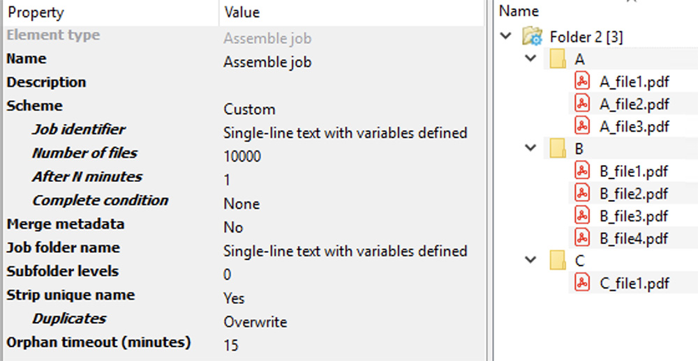

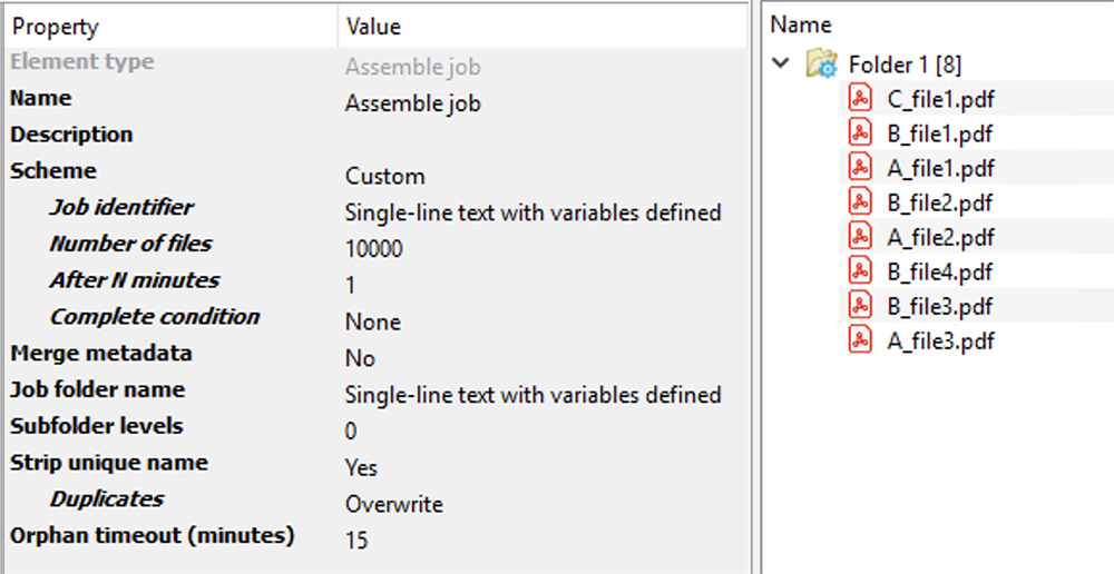

Input:
- as1.jpg (132.76 KiB) Viewed 11885 times
Output:
- as2.jpg (144.79 KiB) Viewed 11885 times
Maybe that could work for you?
