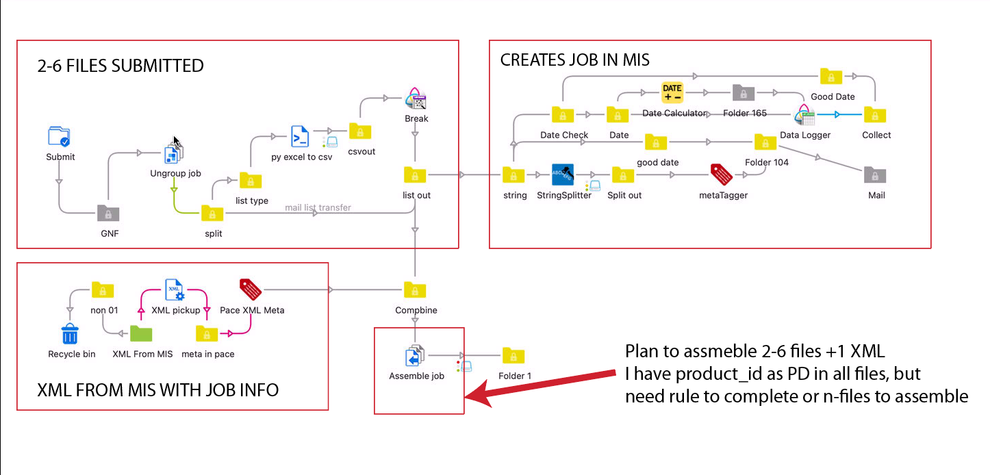

  • I have a flow that starts from a submit point where 2-6 file could be submitted.
  • One is an excel that contains all the new info about the job.
  • I'm split that and converting it all to privateData ( product_id privateData is common ), and then creates a file that pushes to our MIS to create the job.
  • The MIS pushes out an XML to Switch that is picked up and combined with the 2-6 files that were submitted and assembled to combine all the privateData from the submitted file as well as the privateData fro the XML (job number and product_id specifically)
  • This worked great before they changed the number of files that could be submitted
My assemble was using "product_id' as the Job identifier ( all files have that PD) and then number of files I set as an inline since it was always 2 files ( the one submitted and the XML) now that has changed and I can't think of a way to turn the number of files to a variable that I could use for both to assemble based on number of files and/or set a complete condition.
Here is a simplified version of the flow.
Screenshot 2023-01-24 at 7.50.49 AM.png (231.21 KiB) Viewed 9944 times
Thanks,
-O

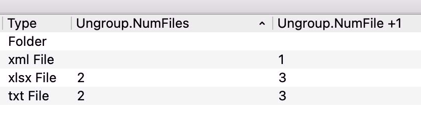

Ungroup.NumFile missing in the XML
Screenshot 2023-01-25 at 6.28.28 AM.png (54.62 KiB) Viewed 9906 times

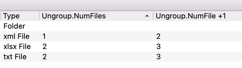

  • After adding the Assemble/Ungroup
  • All files show Ungroup.NumFiles
  • Result of Switch Calculation of Ungroup.NumFile +1 - Submitted files show 3, XML show 2
  • Assemble does not complete, or error till timeout.
Ungroup.NumFile shows but assemble will not complete

The issue is the xml that comes in to Switch from our MIS, will never have the same 'Ungroup.NumFiles' as the submitted ones.
Example:
2 files submitted ( switch calculation Ungroup.NumFiles +1 ) = 3
1 XML File from MIS ( switch calculation Ungroup.NumFiles +1 ) = 2
Custom Assemble Scheme:
Job Identifier = 'product_id'
Number of files = switch calculation Ungroup.NumFiles +1
The result is the XML completes, since 1+1 is true, and leaves the submitted files, 2+1 is false and fails since there are only 2 files there.
I also tried the same thing but without an ungroup from the XML which makes the XML not have any private data for Ungroup.NumFile and the same thing happens except. I then tried to come up with a complete condition but failed there as well.

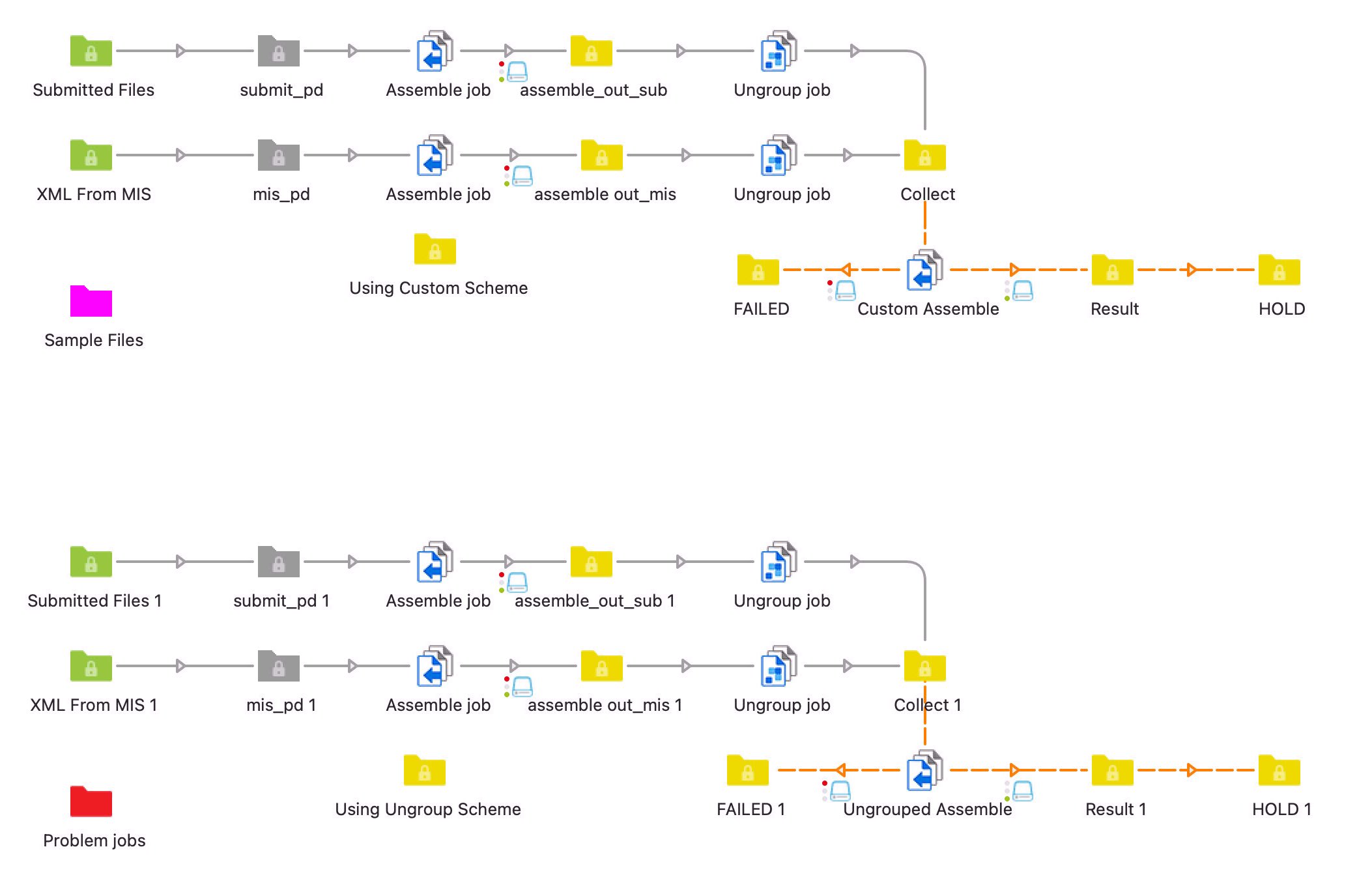

I've attached a sample flow in case this would help or anyone wanted to take a look( one using ungroup one using custom assemble) and 3 sample files (2 excel for the submitted files, and one XML for the file that comes out of the MIS. I set product_id private data as common from both input
Assemble files from multiple inputs.zip
Flow Plus Sample Files
(78.49 KiB) Downloaded 775 times
Flow Screenshot
Flow Screenshot
Screenshot 2023-01-26 at 6.27.43 AM copy.jpg (169.69 KiB) Viewed 9867 times

Right, so the XML from the MIS comes in separately and does not have the correct private data and the assembly fails because of that. I am starting to understand the problem at hand a bit better and this is what I think will solve it.
The files come in and get assembled into a folder. That is 1 job. The XML comes in from the MIS. That is also 1 job (do not assemble it!). If both jobs have the same id in private data you can assemble them with a custom scheme with the id as the job identifier and the number of jobs fixed at 2. The job name should probably not be automatic, but the value of the id. The result is a folder with a folder in it and an XML. Then use "Rename job" with "Files inside job folder - Flatten hierarchy (discarding folders)". The result will be a folder with all the files and the XML at the root level.
This works. So annoying, I did all at first before posting but I was ungrouping the submitted files and I shouldn't' have. Thank you so much.. Easy solutions are often overlooked it seems.
