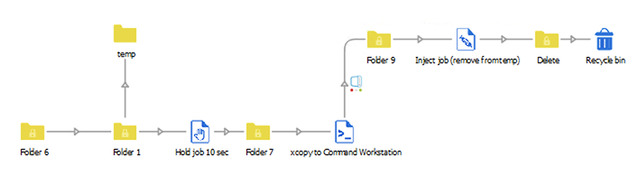

Padawan wrote: Mon Feb 13, 2023 9:45 am I have a done a quick and dirty workaround for this by removing the folder elements and using Execute Command/Run Command to move the job to the output folder.
I did a similiar thing now, but it aint pretty :)
The reason for the temp folder is to get rid of the unique switch prefix, there is probably a better way to do it.

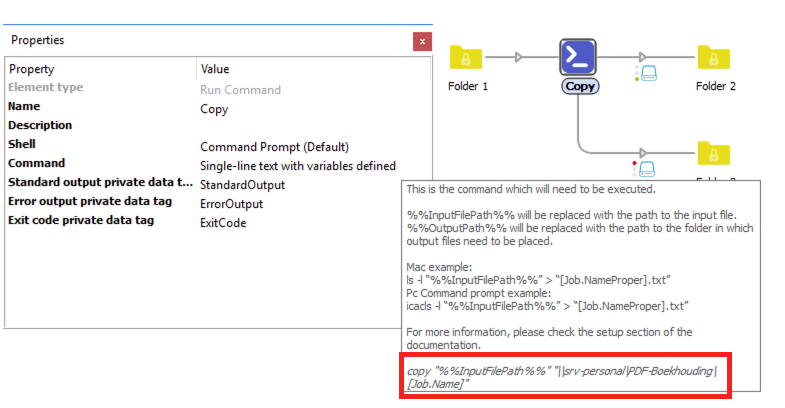

In xcopy you have to provide the full path (including filename )to the source file and the path to the destination folder (excluding the resulting filename).
You can avoid this if you have a command where you have to provide the filename in both the source and the target path, this way you can combine a move and a rename in one command.
I did some quick tests with Run Command and this should be possible with the copy command:
Screenshot 2023-02-14 at 14.44.55.png (132.19 KiB) Viewed 7611 times
This uses this command:
copy "%%InputFilePath%%" "\\path\to\shared\folder\[Job.Name]"
Something similar should be possible with Execute Command

Posted: Tue Feb 14, 2023 3:09 pm
by magnussandstrom
Thanks Padawan, that was so much better. I have changed it now.
